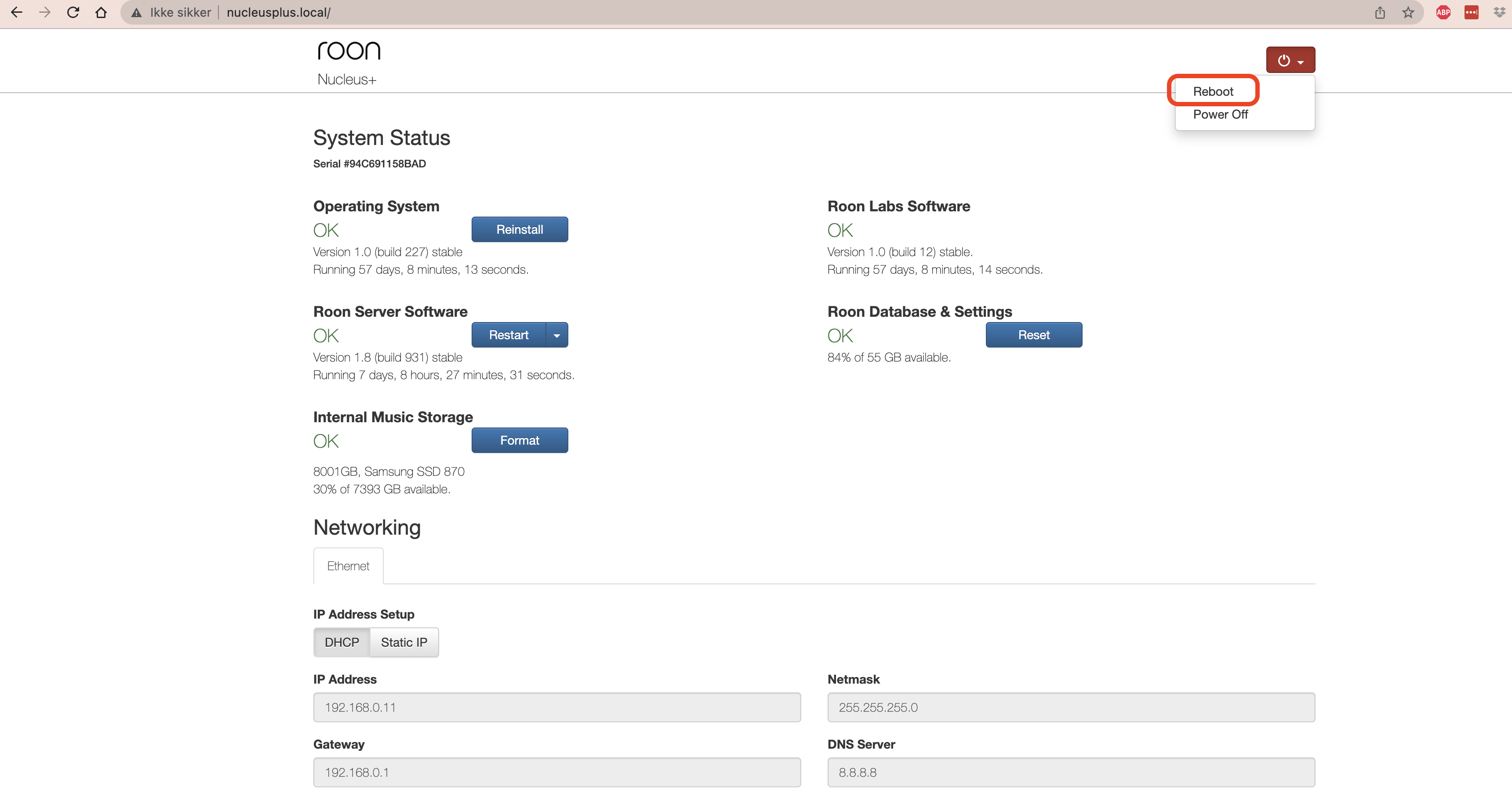

Unless something is off in your network infrastructure (not that uncommon); you can try to reboot Roon from via the web-interface. I have previously experienced similar (years ago), restart of the Nucleus solved it for me.
http://nucleusplus.local <== red button on top right of the page.

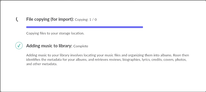

To clarify: The files get copied into the storage very quickly but I keep seeing something like the attached image (showing that files are copying for import). The track numbers change but repeat. In the seconds since I captured the screenshot the track number has changed from 1/0 to 7/13.
The album does not show in my Library.

I did remove one of the imported albums from before and am trying to import it again. It is taking a long time to show up in the network view of the Nucleus+ HD, and although Finder shows 13 tracks on the CD roon reports 38 tracks.
