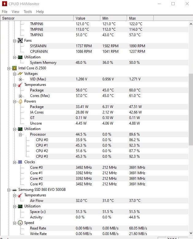

Just for anyone interested in cpu performance.
LMS running
LMS stopped. Roon running.

@Bruss was Roon playing (to one or more zones) at the time or just sitting pretty? That is quite a spike in CPU utilization.
On my sonicTransporter i7, while there are occasional brief spikes for a second or two, the CPU stays under 10% (usually from 1% to 6%, but mostly close to the former) if I don’t have DSP engaged. This is while playing a 96/24 Qobuz album to 1 zone.
Both tested playing the same 16/44 file to the same device. One at a time. The surprising thing is the max peaks. It implies that Roon is resource intensive. If it then hits a comms delay with a recalcitrant end point (Auralic) there could be a processing delay introduced. I’m wondering if a faster cpu could solve the problem and enlarge the operating window. It would be interesting to hear from anyone running an i7 nuc and synching across Auralic plus one other make end point device.

Getting a bit crazy now.
and with Roon stopped
Is Library Audio Analysis still going? Try going to Settings Library and turning Background Audio Analysis Speed to OFF and see if that changes your core usage. The initial audio analysis can be days or even a week depending on library size and other factors.
It has been running for 7 days already. I think I am at my limit of testing the product on my current set up.
