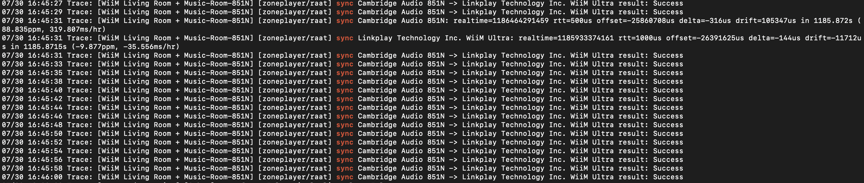

  • As the screencap shows, the Roon logs looks good for keeping two devices in sync. In this example, the Music-Room-851N device is wired.
  • I’ve tried grouping in multiple configurations by starting with one device and grouping another (or more) into the group. No matter which endpoint is first, the WiiM will always lose sync very quickly (and no other device in the same group does).

From your description, it seems the WiiM Ultra, when operating over Wi-Fi, is unable to maintain sync with other grouped zones, even though the Ropieee in the same location did not have this issue.
Since grouping works fine with Ropieee in the same Wi-Fi spot, it’s likely not a network issue. We recommend either going back to the Ropieee setup or using a wired connection for the WiiM Ultra if possible.
