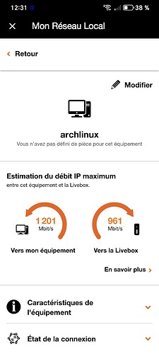

Yes i understand i have to check how powerful is my wifi signal strenght. This morning i manage to have - 50 dBm. Tonight i will try to get - 30dBm by placing the roon server a few meters from my internet box. A few days ago, first time I checked my wifi signal strength i got - 69dBm. I understand that makes a big difference!!!
