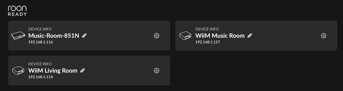

* Primary Roon endpoint is a Cambridge Audio 851N connected via ethernet. Output is analog XLR out to a Cambridge Audio CXA81. Muse is configured on this device with headroom management (-5) and Parametric EQ enabled.
* The other device in the group is a WiiM Ultra connected via ethernet. Output on this one is USB DAC. In the wireless test with the other WiiM Ultra where I was seeing the same result, the output is optical. Muse is configured on this device with headroom management (-3) and nothing else. On the wifi test no headroom is set.

Wired ethernet (cat5) from each device to a generic T-Link unmanaged ethernet switch. Primary network control is handled by an Asus mesh. Each device is configured for DHCP with no QoS set in this wired test. In the wireless test I did have QoS set for the WiiM to prioritize streaming media but no different, that device still drifted out of sync.
