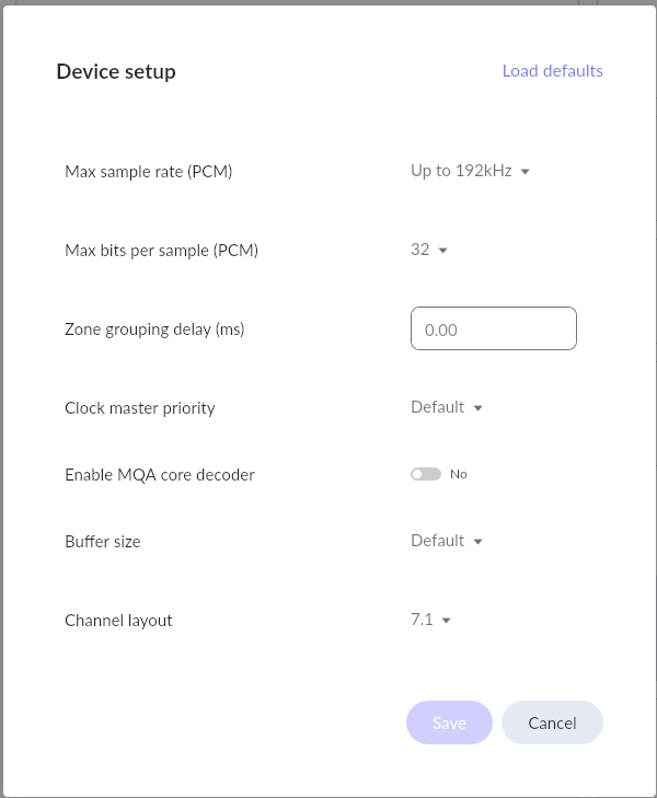

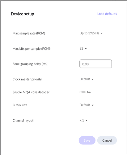

It’s still going to be an an inprovement on AirPlay though?
If it works via the hub, then yes. This is what my (ancient) Denon AVR can use:
