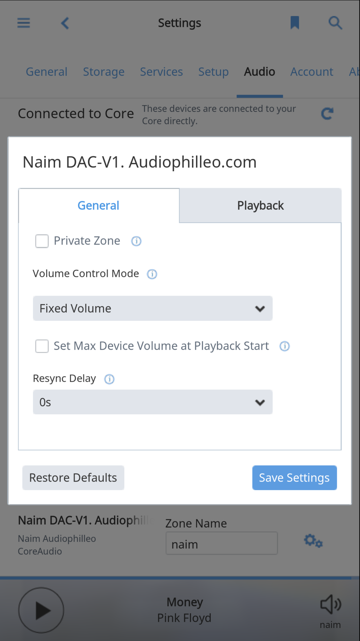

Hi Eric,
Here are my settings:

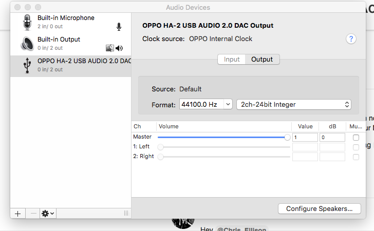

Hey @Chris_Ellison
None of my DACs are able to report bit-depth so I’ve never noticed this before…
But when I play a 16/44 track in Roon, the MIDI Audio Setup on my iMac reports a 44/24 stream. Roon is set to Exclusive mode and the Roon signal path indicates it is 16 bit.
I can pause the track and change the bit depth in MIDI to 16 bits. Once I restart the plaback, it jumps to 24.
It isn’t the NAIM but I’m seeing it too, just never noticed it.
Tom
