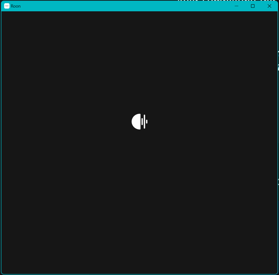

six days ago my windows 11 pro installed and update to build 22621.ni_release.2205006-1250 and it seems to have broken roon. I have downloaded the latest install file, uninstalled my existing install and re-installed from from the downloaded file. It still hangs on a blank screen w/roon throbbing logo, but never completes launch. Task manager shows RAATServer, RoonAppliance and RoonServer running with only RoonAppliance showing the slightest activity.

Roon, RoonServer, RoonAppliance and RAATServer all show in Task Manager, but the Roon app hangs on launch and nothing can connect to RoonServer. What now?
