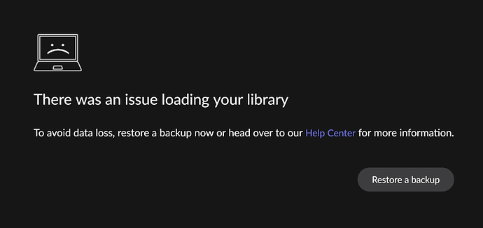

Everything was working fine this morning. Coming back this afternoon, starting using Roon again, I first got a Qobuz login failure.
Logging out od Qobuz and logging in anew, got rid of that issue. However, shortly after that I got the ”There was an issue loading your database” error message.
So I first rebooted the server, and restarted the audioservices Roon + HQPlayer.
After a minute or so, I got the same error message again.
Refusing to accept something was/is wrong with my database, I stopped and restarted Roon & HQPplayer.
Working fine now for over half an hour without issues so far.
Due to the Qobuz login failure message, I firmly believe that something happened whilst I was away from home - internet failure, Roon server failure, Qobuz outage, … that had an impact on Roon server application.
Without changing anything, just stopping and restarting Roon server, the issue seems to be solved (I cross my fingers).
but I am extremely glad that i did NOT (tried to) restore a Roon backup.
It would be great if you could provide me with instructions on where to find Roon log files on my audiolinux server, for you guys taking a look at it.
If this error message is not to be expected/correct, it would be very worthwhile to findout and avoid other users start to execute backup restore without being necessarry.
Dirk

When powering up my Roon server this morning I needed about 5 reboots to get Roon working:
Accessing Roon from my Windows client presented the famous ‘“There was an issue loading your database” error, either immediately of within a minute of use.
For the moment it seems to run back ok, without me doing anything else than rebooting.
I have downloaded the logfiles of today, and in the latest ‘crash’ logfile (Roonserver_log_01), I see
07/04 11:32:48 Error: [broker/database] corruption detected: Corruption: corrupted compressed block contents
07/04 11:32:48 Warn: [broker] detected corrupt database, notifying client
07/04 11:32:48 Warn: [broker] detected corrupt database, halting broker threads

Hey @Dirk_De_Taey,
My apologies for the delay in getting to your thread! I was able to pull a fresh diagnostic from your core, and confirm you’re experiencing database corruption. To put it simply, database corruption means that the records Roon is reading from your database are different from what was originally written.
This isn’t common and can happen for a number of reasons, like failing harddrives or an unstable power source (frequent outages, hard power cuts, etc).
In some cases, corrupt database records can go completely undetected. And it’s only when we release an update that requires Roon to re-scan every record that the corruption shows itself.
These updates don’t happen frequently, which increases the risk of data loss. For example, if you only have a few weeks of backups, the chances that you have a usable backup drop significantly if the “latent” corruption isn’t detected for many months.
Roon now detects database corruption “on the fly”. So if corruption is detected during a backup or during normal use of Roon, you’ll be immediately prompted to restore from a backup.
If you restore from a backup and still see “There was an issue loading your database”, try restoring from your oldest backup.
If you’re not having any luck with your oldest backup, then the only alternative is to start with a fresh database.I sincerely hope it doesn’t come to this, as we understand the time it takes to curate your collection.
I’ll be on standby for your reply. :+1:
