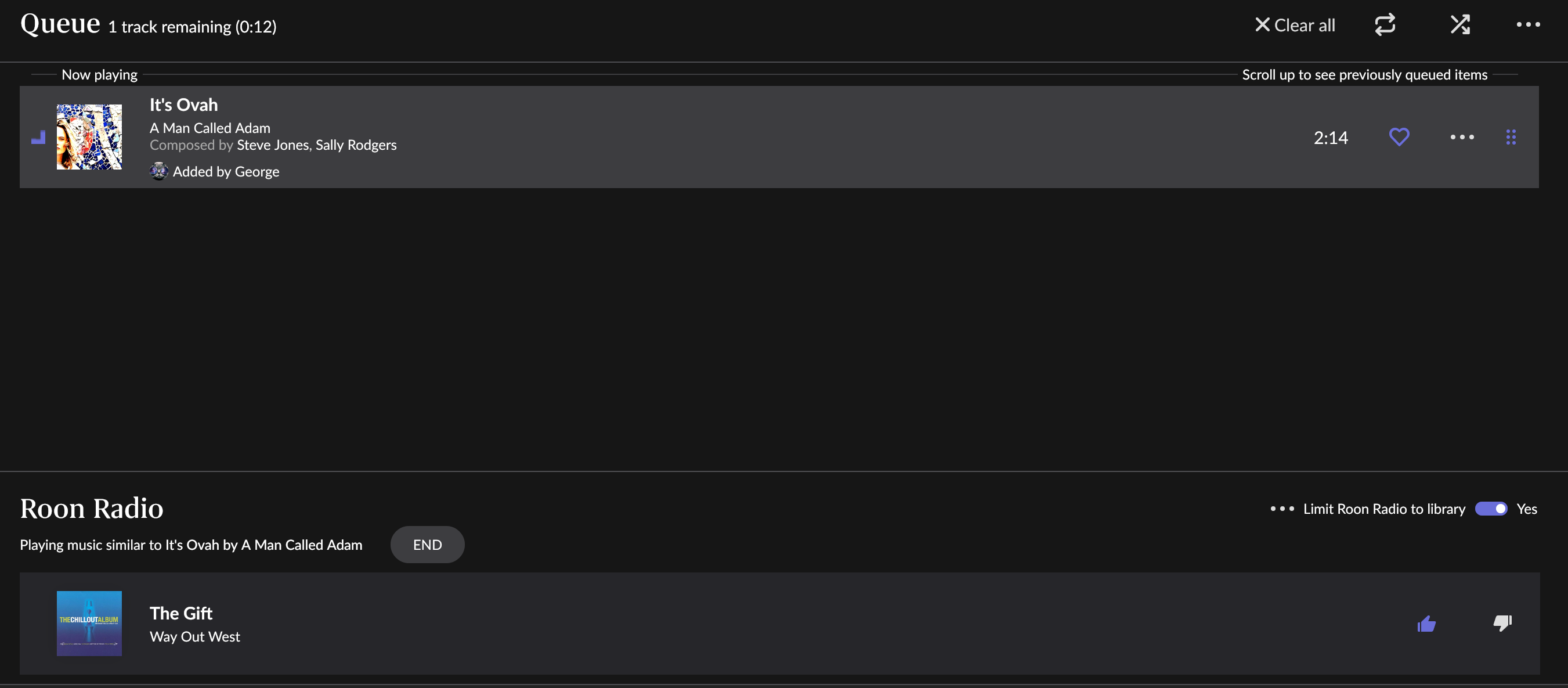

You could try playing around with Tracks and using Focus to zero in on some music, but better yet, try this:
Goto Tracks, Focus on your library, I have Tidal & Qobuz, so you may not need this step.
Pick any ole track you like, and play that single Track, next goto the Queue and using the 3 dots in the bottom right, select Limit to your library, again you may not need this.
This will start Roon Radio, which picks a new song, modeled after what it played last, and randomly should go through your music collection, in your case, possibly forever
