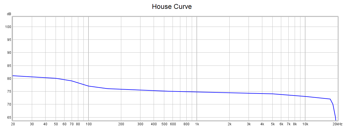

Looking at your measurement, it seems a little low from 150 to 2 khz, I would suggest you ask Thierry to adjust it to something like this (this is the house curve I use):
It will take a few days to get used to the new sound though, and at first you might think it sounds worse.

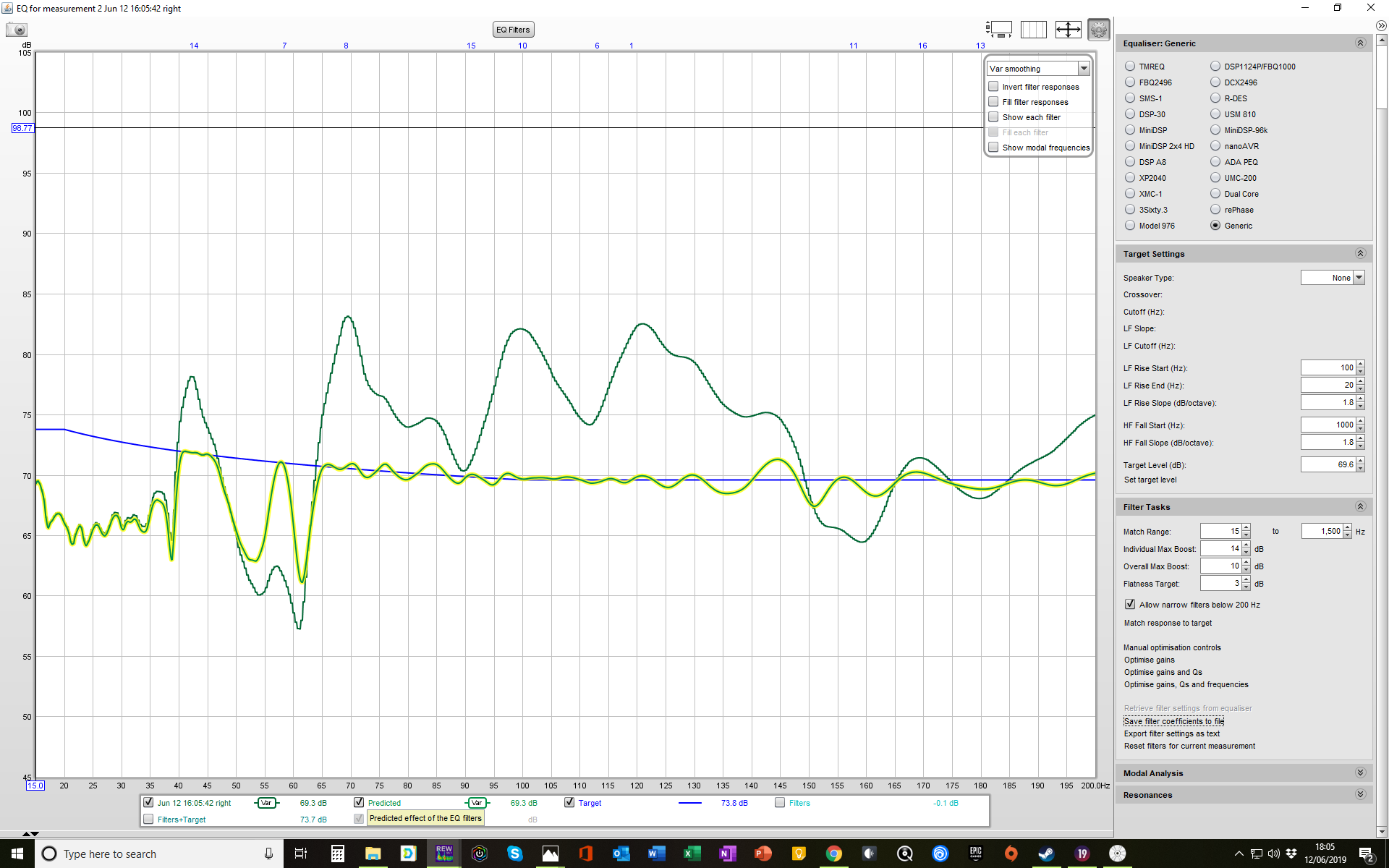

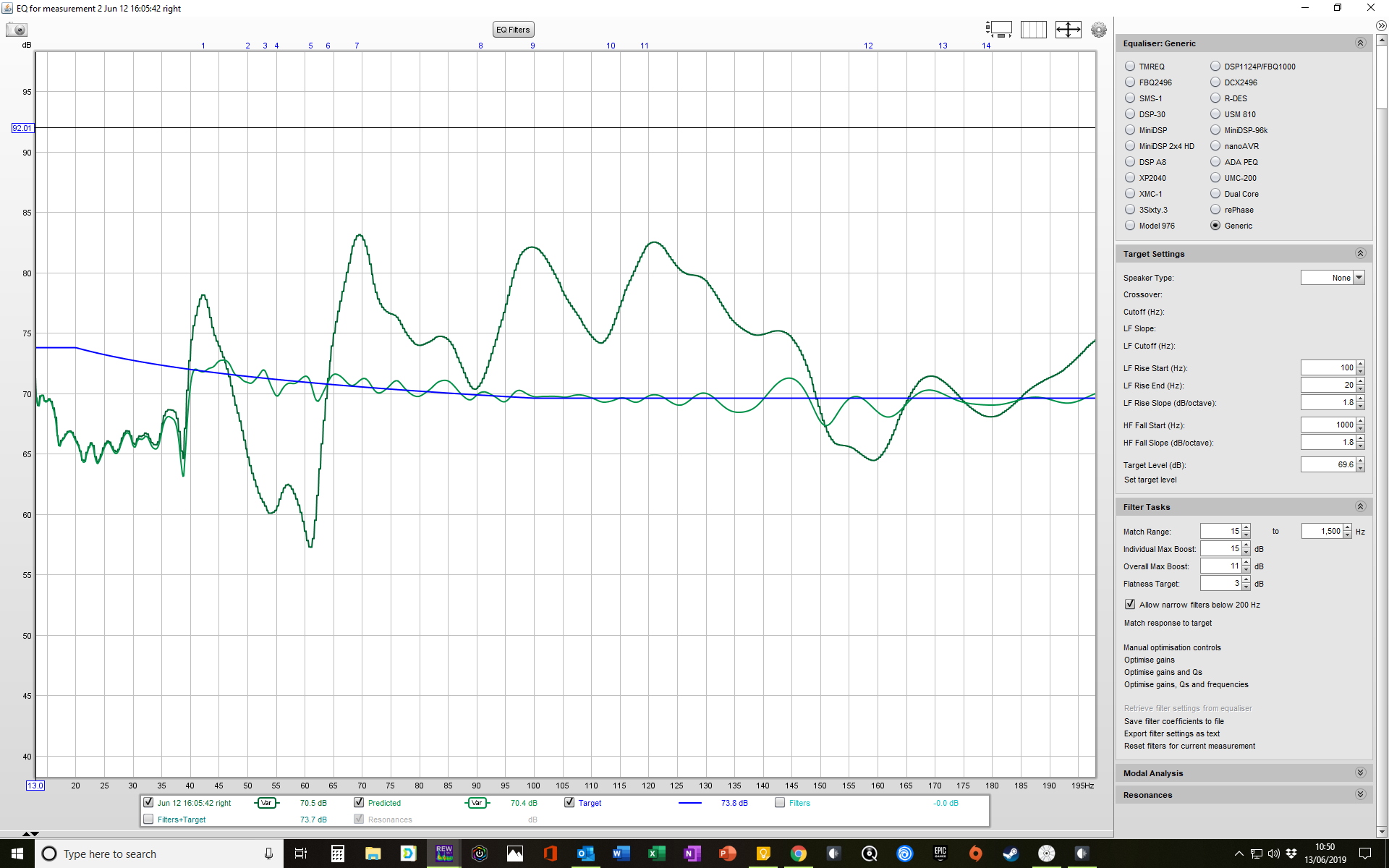

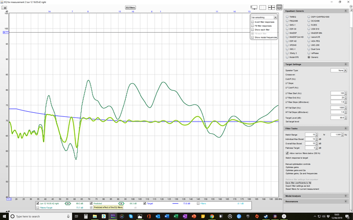

I have previously run through @Magnus guide with my outgoing Monitor Audio Bronze 5 floor standers which I am looking to replace. I have some speakers which I am demo’ing at home, some PMC Twenty5.22. The room is quite tricky, with one speaker in an alcove which results in more bass. These PMC’s are not rear ported and are more forgiving of positioning. They already sound great, but I wanted to run through this process anyway. You can see the right speaker measurement first. As you can see REW makes adjustments, but seems to leave two dips, one around 52Hz and one around 62Hz. I have played around with the settings but I can’t seem to get it right. Should I consider manually adjusting bringing those up to the target?

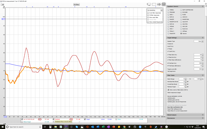

The left speaker measurements are also included below and look okay to me but happy to hear any thoughts.
It’s a bass null-node that causes those dips, and REW don’t fix them if they are to deep. But you can do it manually if you like, by pressing the “EQ Filters” button. If all filters are occupied, uncheck a couple and let REW do the auto-correct again and then you can use the unchecked ones.
This might sound strange, but I would put the corrections in the other channel though, so left gets a couple of peaks that corresponds to the dips in right. The reason is that left channel don’t seem to produce a null node, so correcting on left is likely better, and you won’t hear “stereo” at those frequencies anyway.
Or another approach: do a mono-measurement and correct mono up to around 100Hz, then do stereo correction from 100 and up. It’s a little more complicated to do this though.

Anyway, once I have new speakers in and then run-in, and any acoustic panels I can get away with (I am talking to a company for advice) I will re-sweep but until then I am happy to muck around in REW myself. I did have a go at ‘fixing’ the dips manually, but its quite tricky. Here is the result

WIth my experience: you could achieve better results by doing less corrections.
For example try correction 30 Hz to 200Hz (or 250Hz, or 300Hz)
Individual Max Boost 5dB
Overall Max Boost 6dB
Flatness Target 3 or 4dB.
