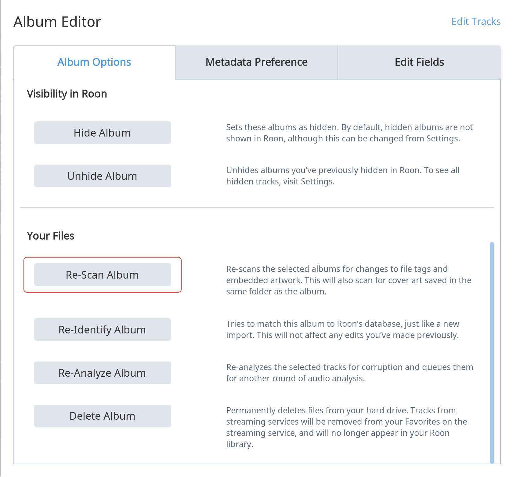

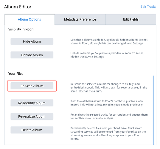

So you’re saying that the re-scan function in Roon is not working for you?
Thanks a lot, Geoff
the re-scan function indeed did the job! The thread I based my workflow on must have been an old one. I can’t seem to find it any more. No problem, issue solved.Thanks.

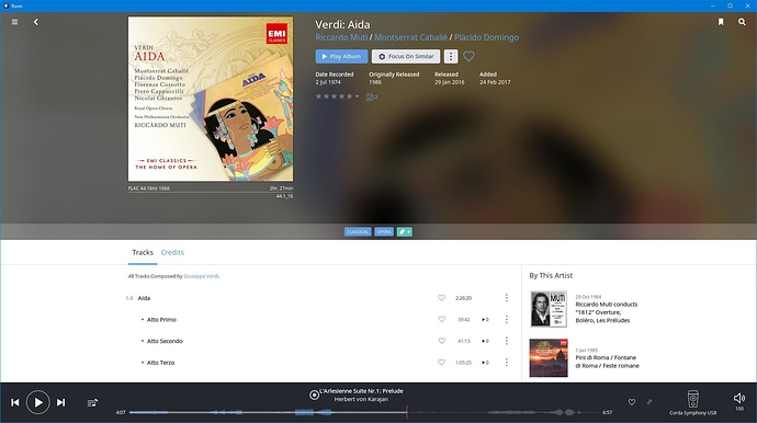

Just tried unidentifying Aida and IT WORKED! Thanks a million.
Also found an edition of Aida that has the “empty” tracks in version #7. Chose that one and my own track names are linked with Roon’s album metadata. Brilliant, thanks.
