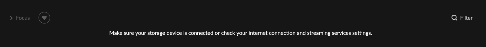

Add to Library or Listen Later feature not working for Tidal in Roon (ref#UO0OVV)
Add to library or listen later doesn't work for Tidal

Hello @vadim, just did it a minute ago. 13:06 GMT+2
