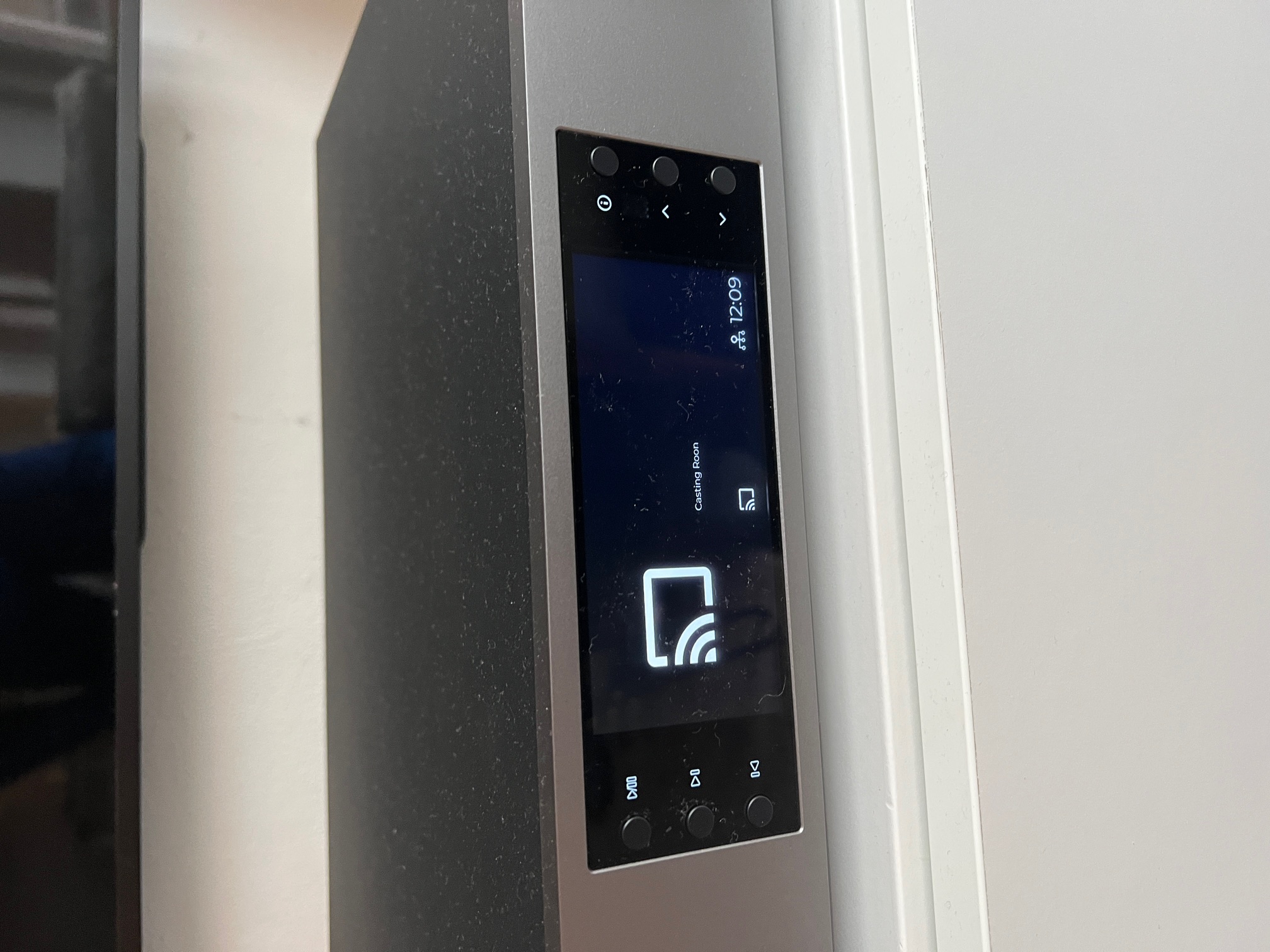

Album art doesn't display when streaming to Chromecast, i.e. Google Nest Hub 2nd gen. It only displays Roon is playing. Also - if I play to a group of chromecast devices (multiroom), Album art does not show on any of the devices with compatible display. Not even the Cambridge CXN100. All displays work fine if I start playback to chromecast devices from a different app, for instance the Qobuz app. Multiroom included.

I have tested some more and here is what happens.
If I Chromecast from the roon app, album art does not show on any device including the Cambridge cxn100. It shows the image I posted. Same thing if I stream to a chromecast group from the roon app.
If I chromecast from another app, Qobuz for instance, album art shows on all devices including the nest hub without problems. Album art is also displayed when streaming to a chromecast group from the qobuz app (or any other app than roon)
Of course there is no problems if I only stream to the roon ready interface of the cxn100. But the chromecast multitoom feature is something I use especially for radio. So I really hope this can be fixed, preferably before my trial ends.
Also I’m curious to know when roon might be fully compatible with Google nest display? To me it seems odd that it isn’t when it works fine from other streaming apps?

Thank you for your patience. We’ve reviewed diagnostics along with your previous post. There’s nothing out of the ordinary from the perspective of the current technical iteration of Roon. What you’re requesting is a feature merger for the Nest Hub between Roon’s Chromecast Display capabilities (which enable display of artwork, metadata, waveform, etc.,) with Roon’s Chromecast Audio capabilities (ie. Cast Zones).
You’ll need to pursue a workaround, as @Suedkiez suggested: Album art While using chromecast devices
Add your voice and vote to the feature request linked there.
