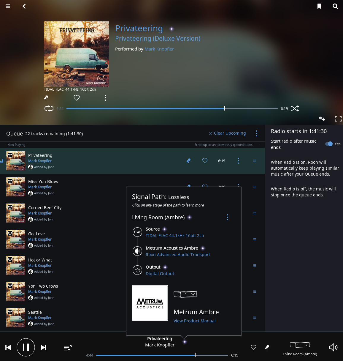

My Ambre arrived today (a day early).
Hooked up - plug and play.
I hear a significant improvement in soundstage - not sure why that would be but music doesn’t seem tied to the speakers. Music is also clearer - especially vocals.
Very pleased. Ambre is connected to Gungnir MB via coax s/spdif.

Old endpoint - cheap windows 10 fanless PC, usb out into usb cleaner and s/pdif into Gungnir MB.
Basically the cheap windows mini pc and usb cleaner has been ditched for direct s/pdif from Ambre to Gumby.
