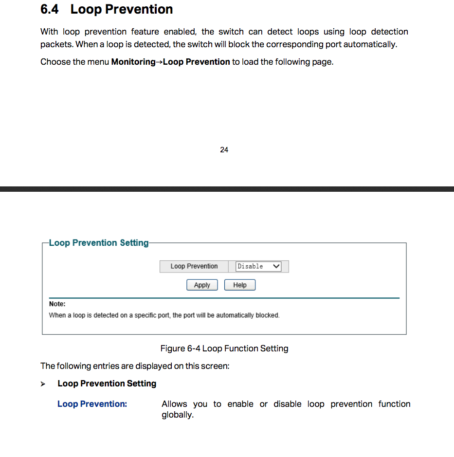

Finally, Loop Prevention (otherwise known as Spanning Tree). This likely isn’t a problem unless you have SONOS devices on your network. If you do then I would recommend powering all of them down and rebooting the switch. Test again and see if that helps. If it does then you should check the Loop Prevention settings in the switch:
If not already set it to “Disabled” and reboot the switch. Add the SONOS devices back in and see what happens. If this is a fix, great. If not then this one gets complicated.
Make changes one at a time and always reboot the switch. You want to be sure to force all of the devices on the network to drop and renegotiate. Also, I’m not at all familiar with the ins and outs of this switch so make sure that the configuration changes are applied and saved so that they come back in the next boot. This is an issue with Cisco switches (changes lost unless explicitly specified otherwise) but I’m not sure about this one.
