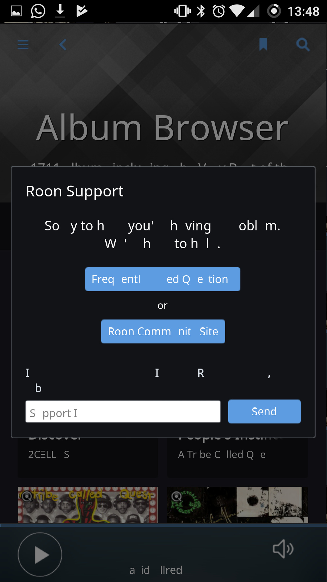

The visuals issue happens everywhere in the app.
I added a screenshot, do you have it?
If not, I will make e new one next time I have this issue. It usually happens when I haven’t used the app for some hours or a day or so.
I then go into Android App settings for Roon, stop the app and than open Roon again and the visuals are fine again.

Eric shared the screenshot you sent him with us, but a couple more screenshots of what you’re seeing on other screens would definitely be a great data point!
Are there any patterns that you’ve noticed leading up to the UI issue? Any other apps that you’re using? Is the device idle and then upon returning to Roon it appears this way?

Thanks for the additional screenshots here, @Ronny_Ruyters.
I have enabled diagnostics on your account so our technical staff can get some more insight into what’s going on here. The next time your Core is active a diagnostics report will automatically be generated and uploaded directly to our servers
Once that’s been received, I’ll be sure to update this thread and pass the diagnostics over to the team for further analysis.
Hi @Ronny_Ruyters,
Thanks for your patience here. I spoke with the team about this and, based on what they’ve found in the diagnostics report and the symptoms you’re experiencing, it appears that your device is running out of video memory. When this happens, you can experience the visual issues that you’re seeing here.
Some things that can help here include:
  • Rebooting your device
  • Closing other apps that may also be using this memory
  • Going to Settings > Setup and lowering the Memory for Photos/Artwork setting
Ultimately, this type of behavior depends on the GPU and how much video memory is available on the device.
Thanks again for your patience and cooperation here! Give the suggestions above a try and let us know if you have any other questions.

Regarding the UI issue, it’s much better now. I ow make sure I don’t have too many apps running.
