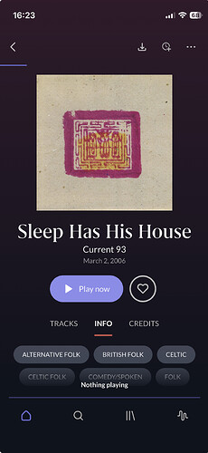

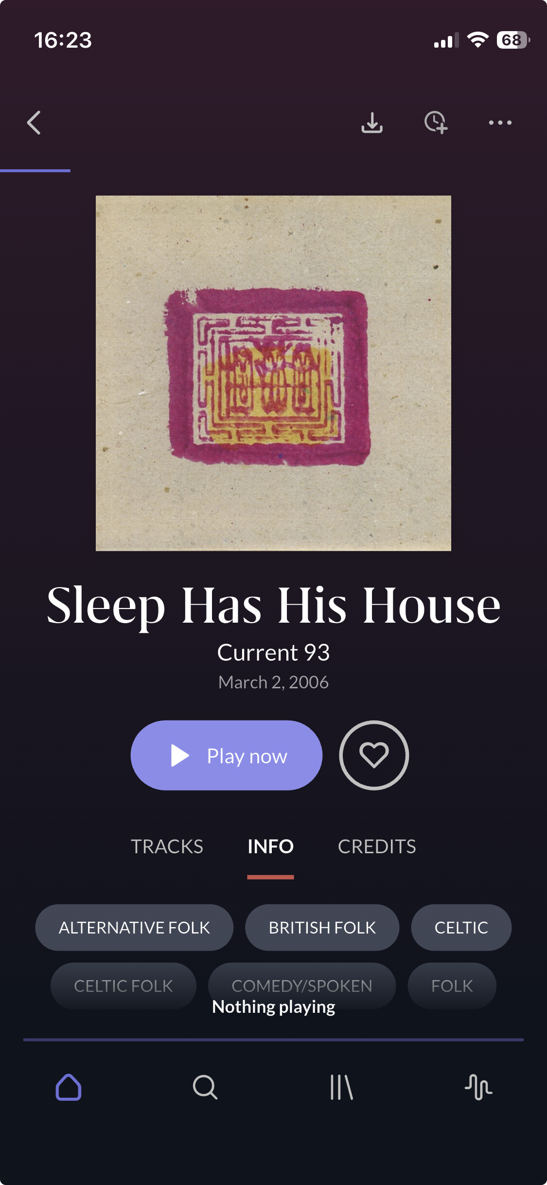

In case it’s relevant to this issue whenever I go into the info tab for an album in Arc the ‘blue flash’ keeps sweeping without stopping until I leave the tab.
