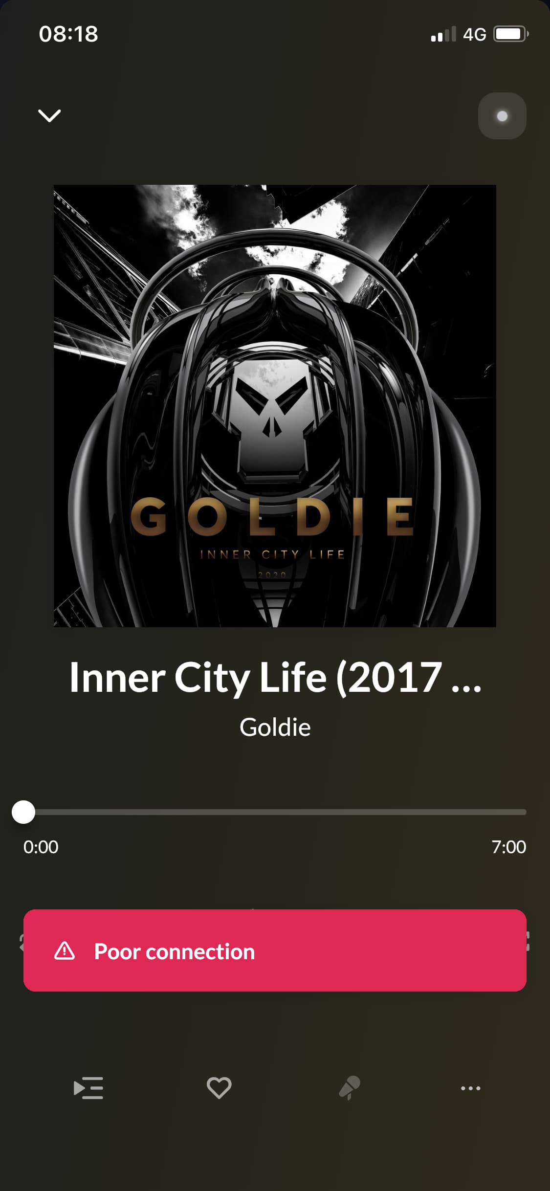

I downloaded the Arc App and was very excited to use it, but it hasn’t been stable for me while using my cellular service. I had a full set of bars indicating the maximum cellular signal and an error message kept populating, “poor connection”. I gave up….
See attached pic and look at the cellular signal in the top right corner. It doesn’t get any better connection then that.

@danny See screenshot below.
