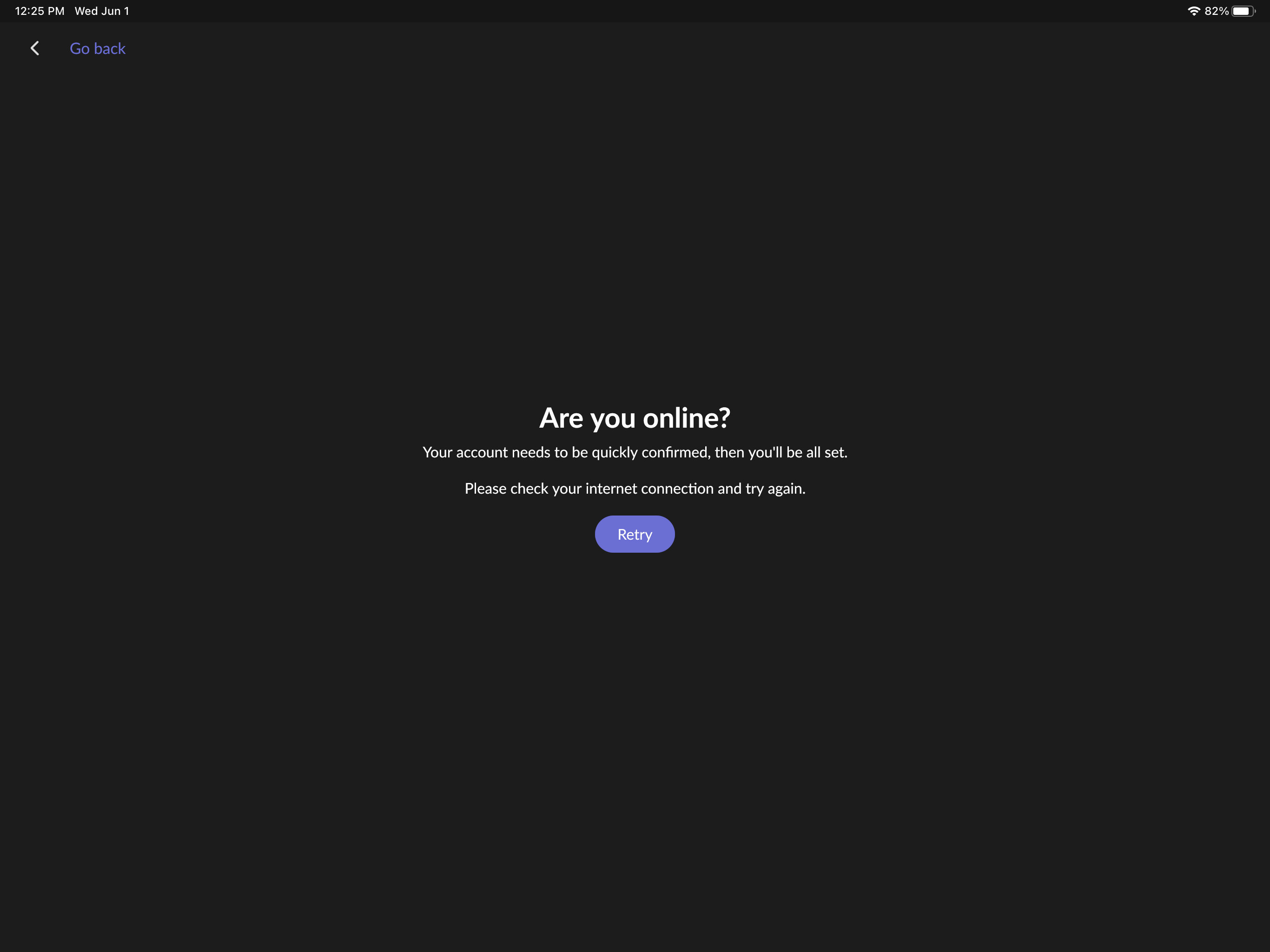

I’ve been using Roon for the last 8 months and had the same problem 2 months ago. Yesterday Roon lost connection. I logged out of Roon and tried to log back in after restoring a backup. The ever-so-problematic “Are you online?” message popped up. Thereafter I couldn’t log in to my Roon account as I am stuck in the “Are you online? Please check your internet connection and try again” page.
Thoroughly checked the internet connection but it has no problem. Tidal, Qobuz or Apple Music are streaming without any issues via Airplay. No problem accessing \ROCK\data. This is the second incident within 2 months.
I renamed “Roon Server” folder to “RoonServer_old in the ROCK’s database, restarted the RoonServer (ROCK) in the WebUI to generate a new Roon database folder, which had fixed the same incident 2 months ago. It didn’t help this time.
I am also having a problem log-in to the Roon community page on my desktop. This issue is new and hadn’t this problem before. When I tried to log in from Chrome (or Fire Fox) browser, after a lengthy loading time, “This site can’t be reached” message came out: “community-sso.roonlabs.net took too long to respond” is the additional remarks.
Fortunately I am still logged in the community with my iPad and able to post this report. What’s the problem? @Roon Please run diagnostics and help!
Screenshots below (x3):

Before the backup restore, Roon was loading, but after the backup restore, the “are you online” popped up again!! :((
