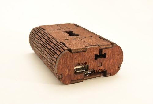

I also burned my image to internal memory. And I use this awesome case.

@fritzg that is such an awesome case, that it has inspired me to start a Case Envy thread. Particularly impressed with the external Power and Reset buttons.
