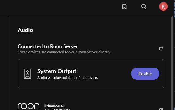

Attached music devices not detected on macOS (ref#7P0GT0)
Attached music devices not seen on macos
Macbook Pro connected to Unifi Cloud Gateway Max over ethernet (have also tried wifi)

I tried going through the questionnaire a few times but I found it difficult to find appropriate options. I thought I’d have a chance to see the ticket before it was submitted. Sorry about that!
  1. Which device - I am not sure how to describe it or what list you see, it is a Macbook Pro 16 inch 2023 with serial number ending in DN.
  2. This is a company device and I am not sure what software is on there unfortunately. As far as I am aware nothing new has been installed recently since it last worked a few weeks back. The built-in firewall is turned off and I disabled my unifi firewall to ensure that wasn’t the issue.
  3. I have just tried renaming that folder and unfortunately issue persists.
