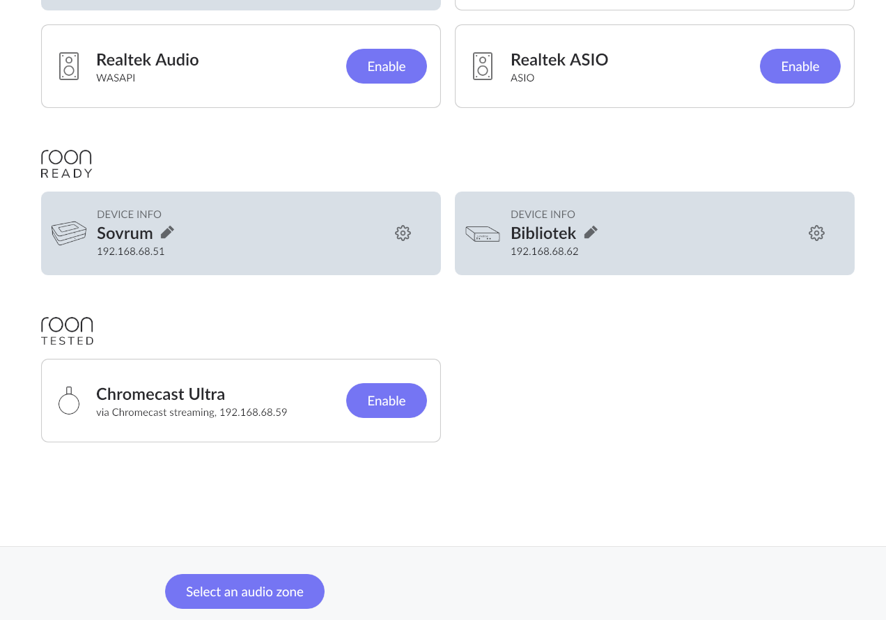

· Yamaha RX-V779, ethernet
Roon suddenly loses contact w my Airplay devices (Yamaha RX-V779, Apple TV). They are on the same network (ethernet) w wifi disabled on the Roon laptop w Win10. Enabling and disabling wifi has helped and it runs for an hour os so, then loses contact. It has worked for years without problems and suddenly the problem appeared. Everything else on the network works flawlessly (Chromecast, tv boxes, nas, printers, tv:s etc), and I can stream music from my Qobuz app on my iPhone to the Yamaha via Airplay.
Router Sagemcom 50001, mesh TP-Link Deco X60, switches D-Link DGS-1016S and D-Link GO-SW-8E

The issue shown in your screenshot has been happening for a few years on my setup & it may, or may not, have been exacerbated by recent updates.
During the period I have had the problem I have changed my entire network topology 3-4 times. The problem is intermittent so near impossible to demonstrate, hopefully with R&D taking a look at the problem it will finally get resolved :crossed_fingers:t2:
