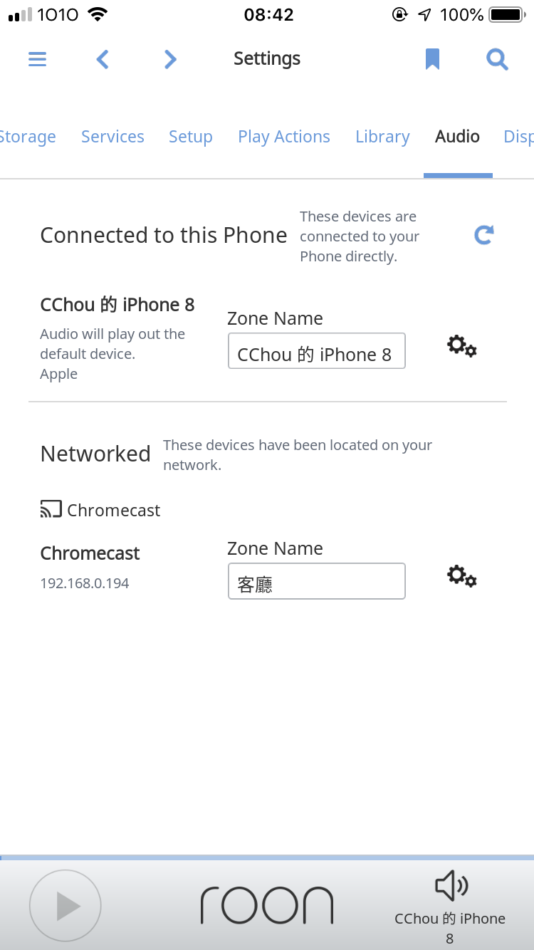

Yes the NAS has connected to DAC and its input is set at USB. Here you may see one is my Roon remote screen shot which does not detect Ayre DAC, and another pic is screen shot from roon server which shows it connected to Ayer device. Hope this explains

Thanks for sharing those screenshots as BlackJack requested! It appears that you might have some kind of firewall blocking Roon’s discovery process since I noticed that the Networked area of your screenshot does not display any info.

What I miss on all this screenshots is the section about the core, like this from my core:
grafik
It’s not only the USB DAC missing, also the local sound card HDA Intel in’t there.

Doesn’t look so. Your MBP isn’t shown as Core, only as Control/Bridge. Your Core is still missing in Settings|Audio.
