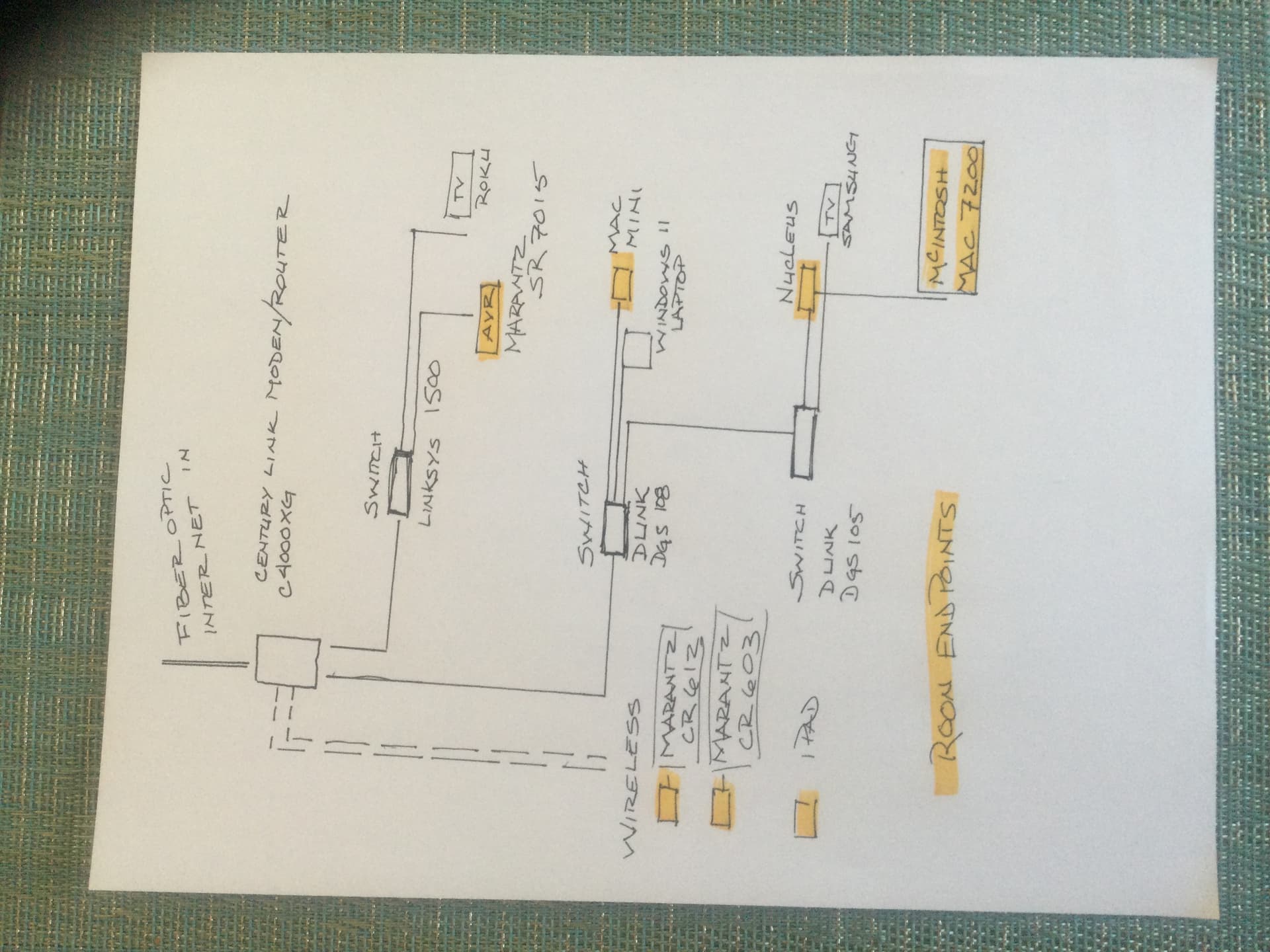

It would be helpful if you could show us a diagram of your network showing how all your devices are currently connected. E.g.:
You don’t have to produce a fancy diagram like this; a photo taken with your smartphone of a simple pencil sketch will do…

Here is the current situation: The zone labeled Cavern is the Mac Mini. There should be endpoints or zones for: --the AVR (SR7015) --the CR 603 --the CR 612 All of the zones showed up, and played before I changed the modem/router combination. That was the only change prior to the current status.
Thanks again for your help.
Thanks for the diagram and screenshots. Very helpful, but puzzling, because the network configuration looks fine, and yet clearly there are Audio devices not being seen by the Nucleus.
