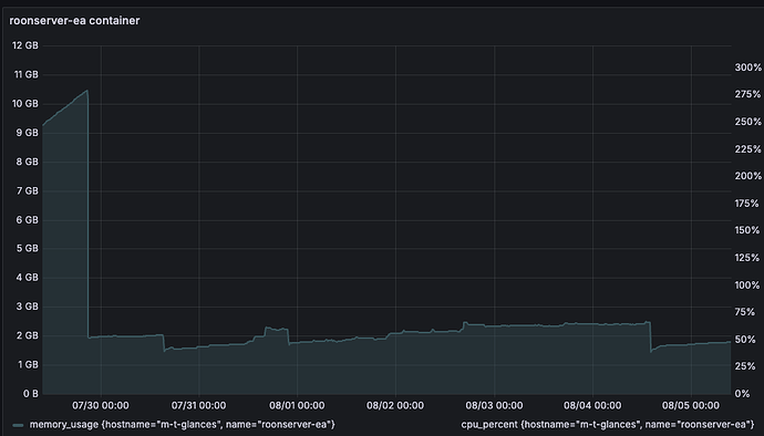

I didn’t install B1552 and went straight from 1550 → 1553. I haven’t seen any new functional issue in 1553 and memory consumption looks similar to 1550.
Here’s 7 days of EA. The vertical drop on the far right is the upgrade from 1550 → 1553. As you can see, 1553 so far looks pretty much identical to the last couple EA builds that have included the memory leak fixes. Of course on the far left you can see the tail of the last build that did not have these fixes.
B1553 looks good to me.

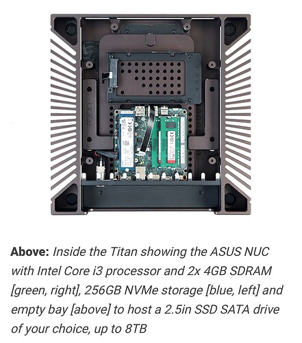

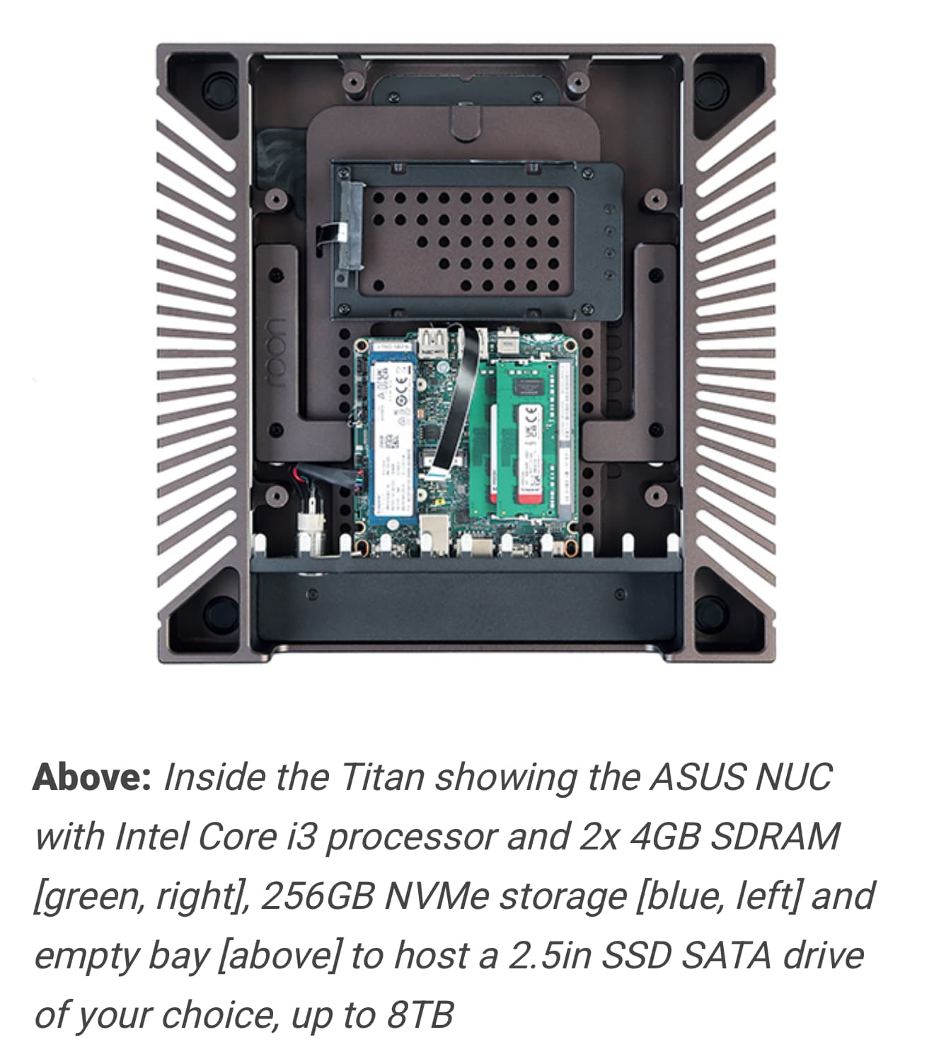

Are you indicating that the Nucleus Titan has a … DIMM that can be replaced to increase memory, even though we can see that the macOS version is limited to 8GB? (I don’t know whether they’re running Mono on the Titan’s Linux setup but I’m guessing they are).
Yeah I found the instructions. I’ve ordered 2x16GB (the suggested DIMMs are EOL, so a downclockable replacement from Crucial), and we’ll see what happens. (I don’t think it’s going to fix the problem…)
Sad that they used an i3. You’d think they’d use an i5 or i7, but…
