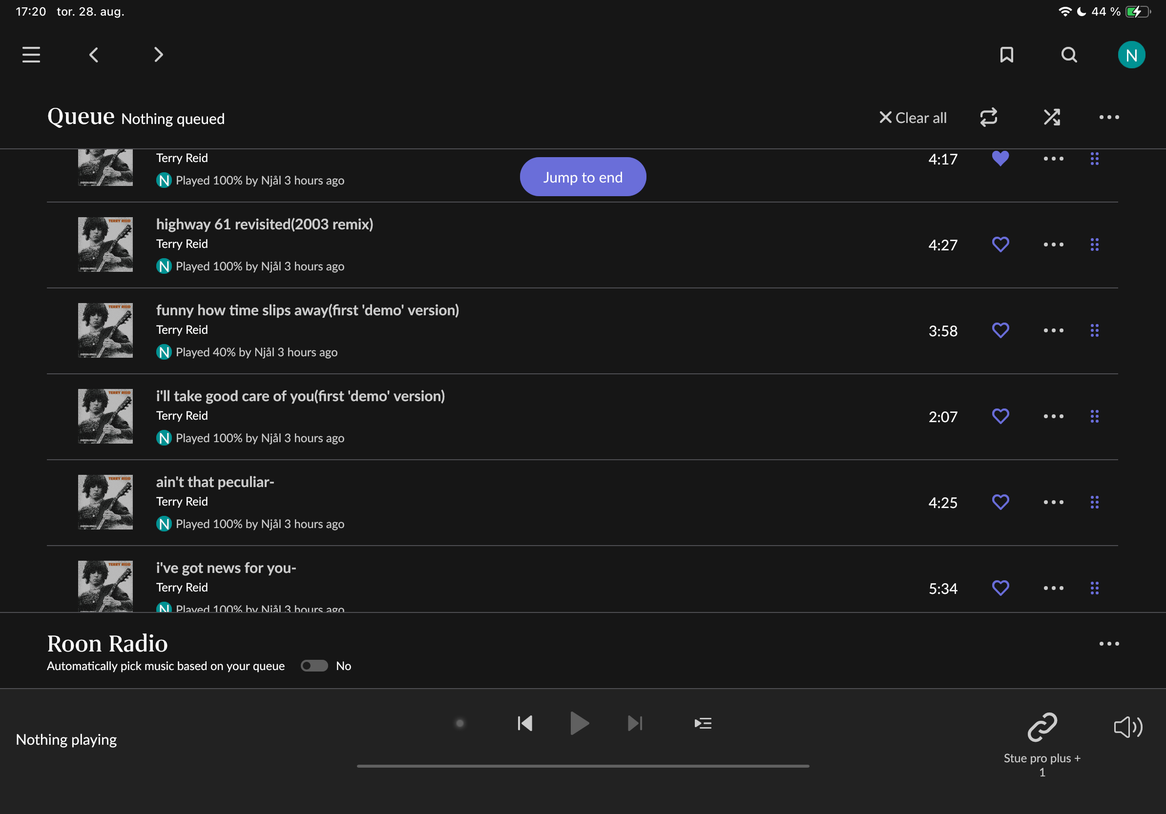

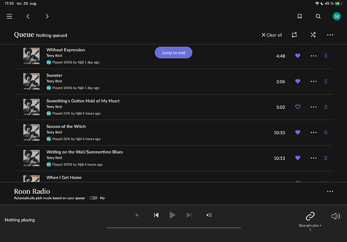

I’ve also had similar today (didn’t play any music yesterday), music would stop/pause during playback, when checking Roon it would say “Find something to play”, then it would continue playing by itself, once from where it stopped, I believe at one time from a bit further into the same track. It also states I’ve only played a percentage of at least one of the tracks that stopped, then continued playing.
Added: Funny How Time … paused, then continued, but possibly not from the same place:
but Season of the Witch continued from the same place, but I jumped back to the start of the track, which isn’t shown here:
