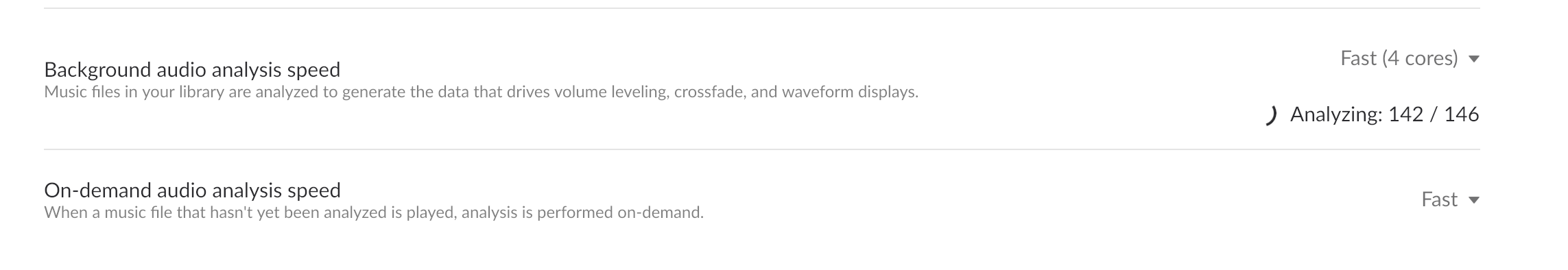

Unfortunately, no go. Although I got no errors, I still get a hang with whatever seems to constitute a set of (final?) four tracks before completion:
But I see that you think that there is one set of four tracks (etc) which is causing the hang.
It’s always been four since we opened this ticket in January. But of course it’s a different set of four each time I import a new Album or handful of albums.

I know I can temporarily appear to clear the hang both with Settings > Library > Background Audio Analysis > Off (and back On); and by restarting the Roon server. I did the latter about 30 minutes later.
