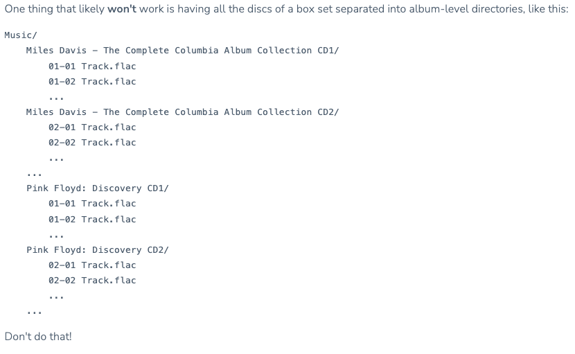

As long as you aren’t naming albums “CD1” and “CD2”, etc. into separate folders that are also named “CD1” and “CD2” you should be fine.
Here’s more info on this from our KB:
Here’s an example from the KB:
Roon would reanalyze anything it doesn’t recognize when it scans. So anything changed outside of Roon will get treated as a new object, which could again slow you down. Making your changes within Roon vs the original files will likely save you any headache in this area. :+1:

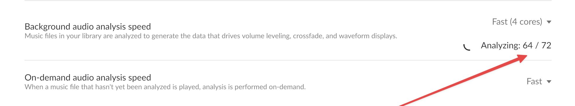

But my concern is that, typically it shows something like ‘339/553’ before analyzing; and displays no evidence of picking back up (where it left off) after a restart of the server.
In other words, no analysis takes place after a restart.
Is that what you’d expect?
Is the act of restarting actually curtailing analysis? Or is this just a cosmetic bug, as has been suggested by other users?

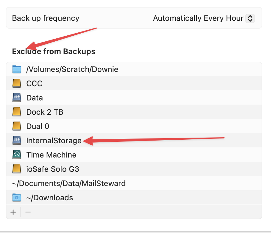

From a fresh diagnostic report, we’re seeing frequent error traces in relation to Time Machine on the iMac. Do you have Time Machine actively running on the Mac? If so, it’s known to cause issues alongside Roon. Is Time Machine touching the same local library you have set as watched folders?
I’d be curious to see if disabling Time Machine may help you with finishing the analysis. Here’s a good discussion around it: MacOS Time Machine Question - #2 by Robert_F

I do, Yes.
Even though they’re separate Volumes, and even though the Nucleus device/volume is specifically excluded from Time Machine?
No. Not at all.
My local library/watched folder is on my Nucleus (Linux/roonOS).
Time Machine only backs up from Macintosh HD (macOS).
Could it be that the very act of having the ‘Internal Storage’ directory on my Nucleus specifically ‘mentioned’ in Time Machine’s options may be causing the errors, Benjamin?

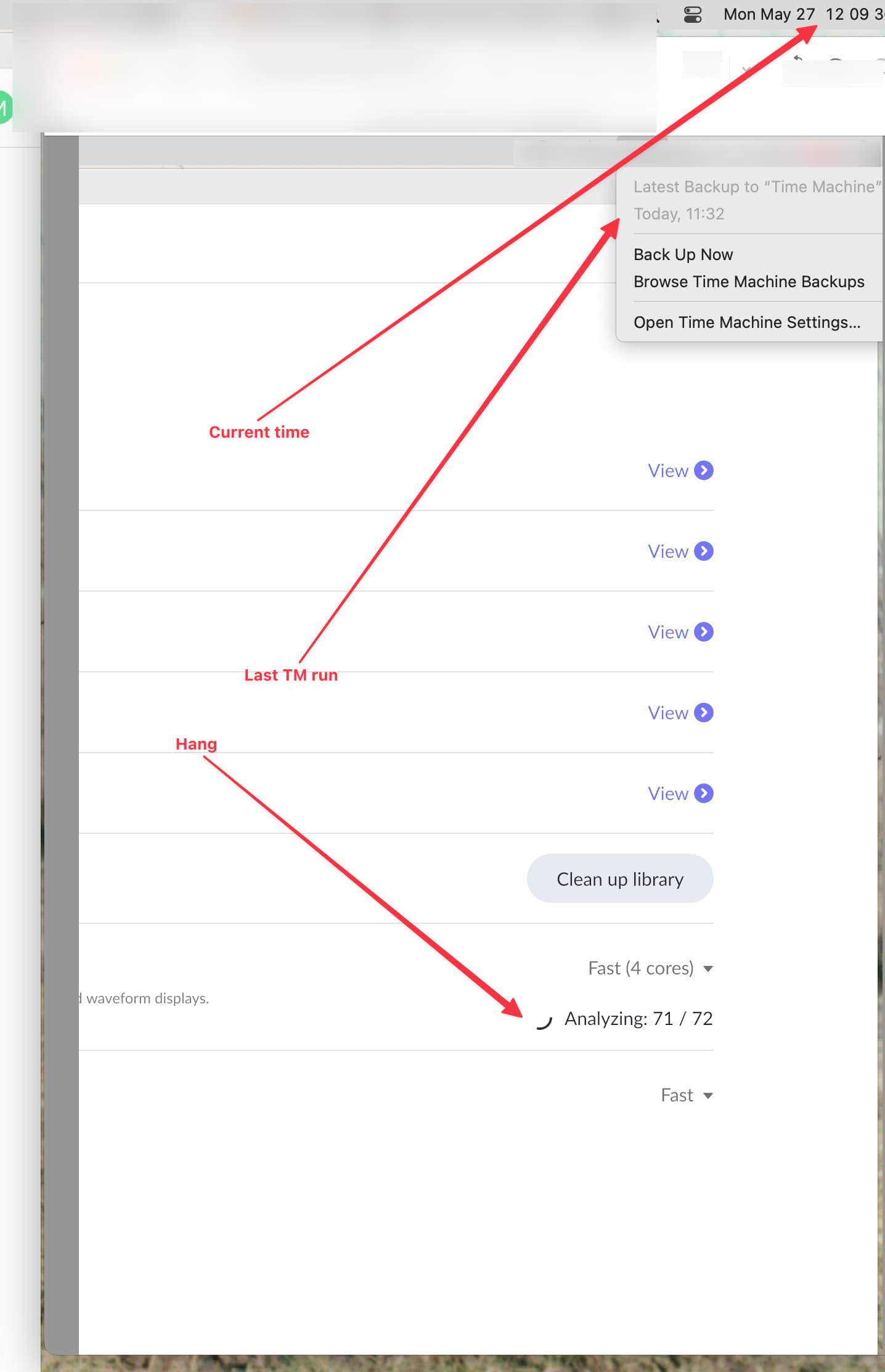

Have been experimenting extensively with the apparent audio analysis this last week.
Specifically, I’ve been avoiding any possible contention with a Time Machine run.
TM is set to the default, every 60 minutes.
Here’s an example.
  1. I stopped my Nucleus server via the web interface
  2. waited several seconds until that had time to ‘settle’
  3. renamed a half a dozen or so folders in my watched folder; equivalent of importing
  4. waited a minute or so again
  5. started the Nucleus server via the web interface
  6. waited several seconds until that had time to ‘settle’
  7. launched Roon
  8. watched progress in Library > Background audio analysis speed
It seemed to finish. But then this:
I hope it explains the issue better. And confirms that Time Machine is not involved.
No actual error messages.
Happy to help with further testing, logs, experimenting etc.
