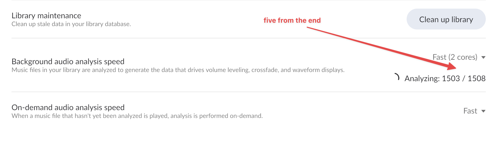

@daniel - having continued to observe closely the stalls, I can confirm that:
  1. the ‘current’ and (presumably a calculated) ‘total’ numbers don’t immediately seem to me to correspond to (recent) imports… for example I just imported this set of 11 CDs; nowhere can I see how 1,508 could correspond to a figure in any new or recently-updated track total in my Library, or the delta with last time. Is this something that you would elicidatre for us, please, Daniel? Thanks!
  2. the stall always occurs five tracks from said (presumably a calculated) ‘total’ number:
Looking forward to the results of your investigations…

I confess to being a little puzzled about this, though:
and I’m sorry if I wasn’t clear: this stall happens every single time with every import which I make.
So wouldn’t your colleagues’ suggested theory be more likely to apply to one instance?
Surely IDs don’t change and cause these stalls for so many of us every time any of us imports?
More details would be helpful, please?
Particularly since others are experiencing this!
