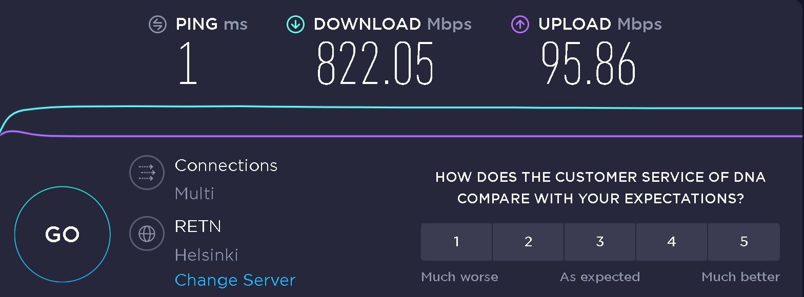

Wow (10 characters).
Is it real or just Photoshop ?
To rub salt in the wound, I’m guessing the charges are the equivalent of $30 a month?
It is real.
34,90€/per month.
