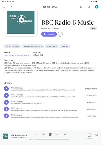

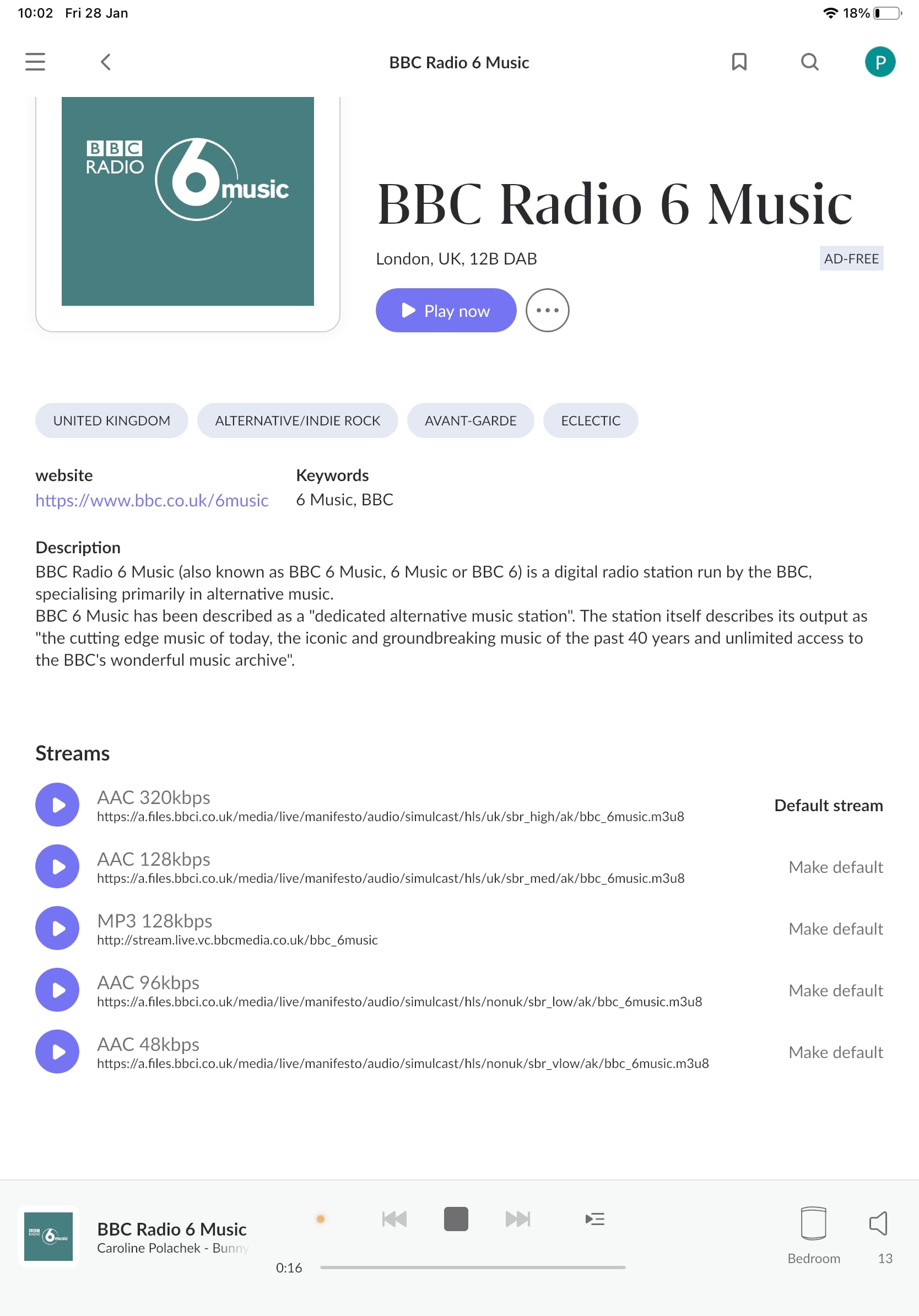

At 09:58 I had Tidal streaming playing fine on my bedroom sonos , transferred 6 music to the bedroom and it cuts in and out every few seconds.
At this point i went down the list of streams starting at the default and they all cut in and out.
At 10:14 i couldn’t stand the cutting out anymore and swapped to Tidal and it’s fine, also the wife is streaming tennis to her ipad and it’s fine, we get about 69mps so bandwidth is not an issue, the cut offs happen if i use my wi-fi network or if i put ethernet into the sonos speakers to force them to use sonosnet.

No change for me this morning, all of the 6 music streams have clipping and cut offs, if I change to the Radio Paradise which is marked as a FLAC stream its OK.
