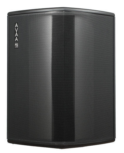

Otherwise the only options are tuned diaphragm traps like
Or active traps like
Unique: easy to set up and move, no calibration required, as efficient as passive absorbers 25 times its size, the AVAA C20 typically reduces the resonance time of all room modes between 15 Hz and 150 Hz by up to 50%.
