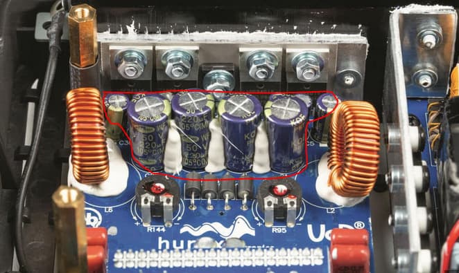

Personally I think the capacitors at the output of the Hypex-module are not inside the specs any more.
So I presume that changing those capacitors would do the trick. Of course, this is not that something anyone can do, but a reasonable technician should be able to perform this task.

“ There were a number of things that were fixed in the Powernode.
A few capacitors on the main audio board had dried out so werent operating properly and the top touch panel had failed.
All components were replaced and the unit is back to working order.”
