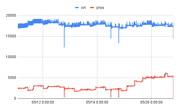

The problem with this issue is that it must depend on some hard to replicate, relatively rare combination of factors. Over the last several years of running Roon on Ubuntu Server (20.04 and then 22.04), 3 different systems in different locations, I had only one relatively short period with concerning physical memory growth on one of those systems. Here’s a typical memory graph for my most used server (the short drop-to-zero events are reboots (Ubuntu updates) or new Roon Server releases.
roonmem

There’s definitely something happening occasionally. Here’s the memory graph for one of my Roon servers. I reboot them for Ubuntu software upgrades, and RoonServer for new versions. I have no idea what was going on May 19-27, but nothing very different from my usual usage on this server.
tamarack

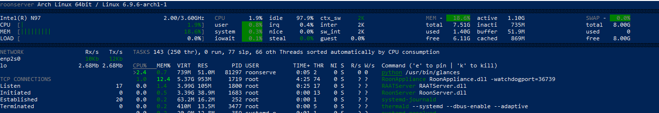

I have now spent 5 days with Roonserver running exclusively an Odroid H4 (based on Intel N97) with 8GB of RAM running a minimal headless installation of ArchLinux which is connected via ethernet to the LAN. The H4 is also used as the main USB audio endpoint thereby replacing a separate RPi4 running Ropieee. Roon ARC connects fine. IPv6 has been deactivated in dhcpcd.conf.

Roon has been playing >20 continuous hours while I’ve been working, and I’ve let it run through the nights via Roon radio, and so far it performs very well with no glitches or latency issues. I have not altered roonserver.service and RAM now stays consistently between 18% and 22%. A few tweaks were necessary to run smoothly:
Without interrupting the audio stream or getting stuck, there were moments where Roon app briefly showed the lost connection icon. Also my ssh connection got disconnected quite often. Since the default linux network buffers are rather low at 208 kb. Increasing buffers to 16384kb in sysctl solved both issues and improved latency of the Roon music UI, scrolling through music library, etc. This did not have any noticeable change to RAM being used. I tried 32768kb as well which appears to be no different to 16384kb, not better or worse.

Also while still running smoothly there were 100% CPU spikes from time to time. The default linux CPU governor setting is ‘powersave’ where the H4 was often running at the low limit of +/- 1.4Ghz. While changing the setting to ‘performance’ definitely fixed this, it was running at a minimum of 2.5Ghz constantly which was raising the temps up a bit. I ended up setting the state back to ‘powersave’ but setting the minimum range to 2Ghz which solved the problem as well without idling so high. I have not seen any more max CPU spikes.
