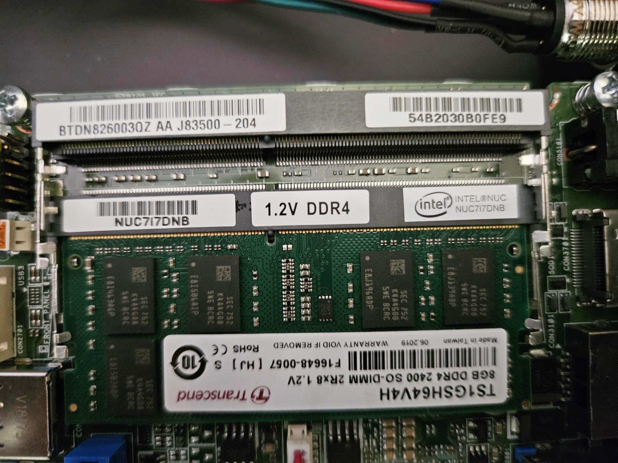

If I need to download the bios, I’ll need to know which one. Screenshot is of my board and I think this is the page of where to find it. Can you confirm or tell me if this is the correct file?

It’s possible that a new SSD will help in case the current one has a hardware failure, but this is not clear yet. I would also suggest taking out and re-seating the RAM, if the RAM has failed then it is possible that this is also preventing a successful boot.
