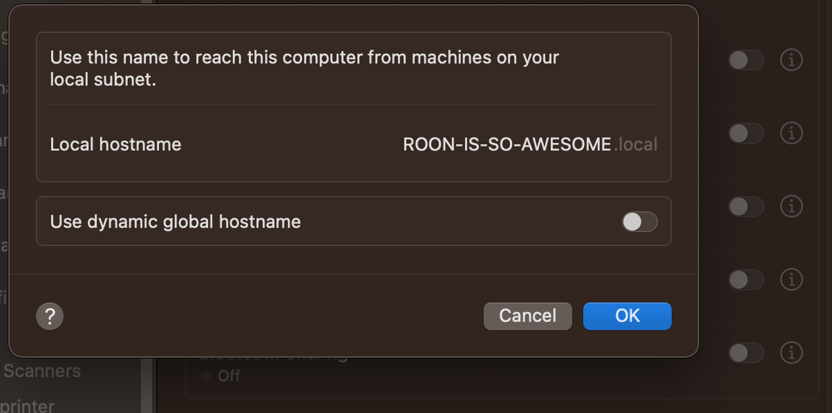

I have noticed that since Ventura, the Sharing panel in macOS no longer gives the computer’s name with the suffix “.local” for sharing, as depicted in the Roon instructions above; it only gives the format as “smb://IPaddress.” So, I am typing into the Roon dialogue box this: “smb://IPaddress/folder-name” (or just “\IPaddress\folder-name” [I have typed two back slashes at the beginning but the text renderer here is not showing one of them for some reason]). Then the username and password for the Roon user account that I had created on the Mac (the account itself has only Sharing privileges and is not an Admin account).
Could Apple have broken the process that used to work by adding new security features or something?

It looks like there were a few similar reports on Ventura, have you tried toggling File Sharing off and then back on yet? This has helped others in the past:
Thanks, now that you mention it I had tried that earlier and gotten it to work for a while, but then eventually it would stop working and the automatic backups would also then stop. With your reminder I tried it again, toggling File Sharing off, restarting, and toggling it back on, and I was able to connect.
