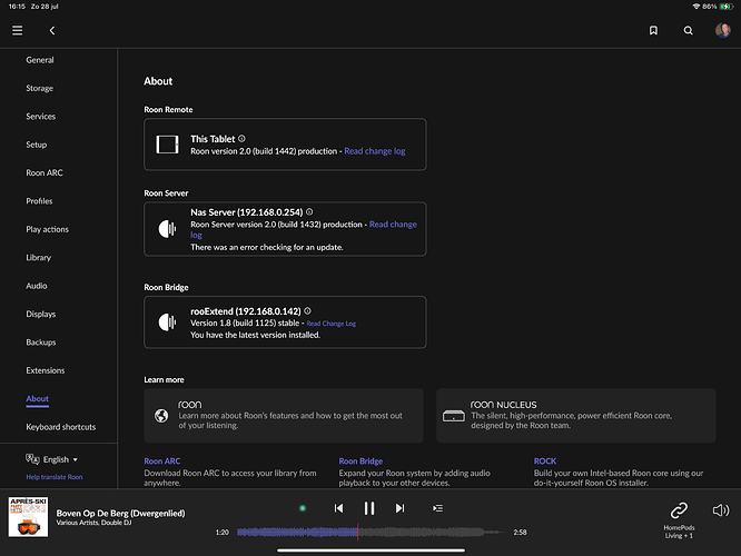

Can not update
impossible to update ?
I try already 1 week
Are there others who are also experiencing this?

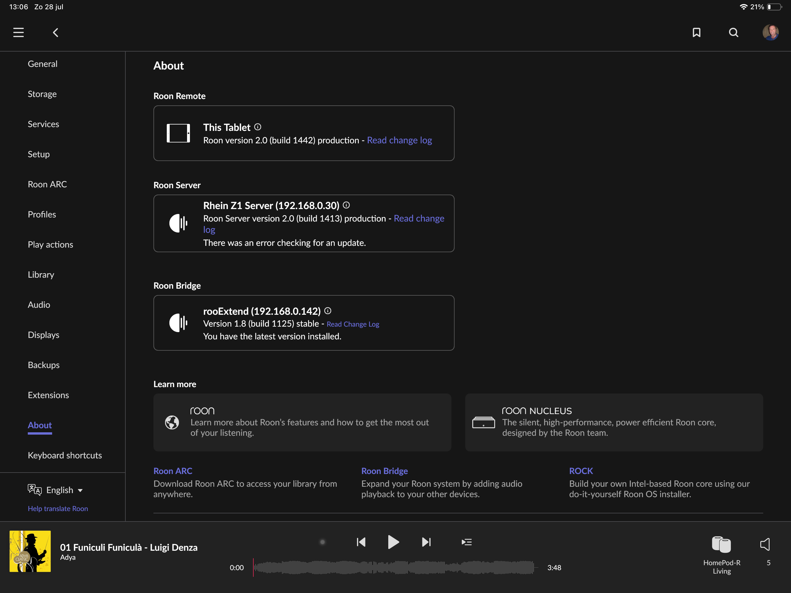

I had the build 1432 on it then the build 1442 doesn’t work.
I then removed roon and reinstalled it, but now its on build 1413.
The server is the Rhein Z1 Silent Angel
I know, and it is not licensed to use Roon Server by Roon Labs…
oh sad, and what about the synology nas. This core also won’t update

Hi @Patrickvm,
Typically this error message suggests that the Roon Server cannot reach Roon’s update cloud servers.
I’ve read you are experiencing this issue on two instances of Roon server which again suggests the issue is upstream of the Roon Server itself.
I can’t completely rule out a back end Roon issue, however, I’m not aware of any global Roon Cloud server issues (the forum would be overrun with user reports).
Given this, I’d recommend the following troubleshooting steps…
  1. Reboot your network router, wait a couple of mins for its boot sequence to complete and then reboot the device that you are running as the active Roon Server.
  2. Identify what the DNS server your LAN is using, if not Google or Cloudfare consider changing that in your router’s settings.
Searching the forum, There are a number of good reports from Roon user that have switched to Cloudfare.
If none of that helps, then I’d suggest creating a Support topic for this issue Roon Server on Synology NAS (as that is a supported device) and once solved hopefully it will also resolve the issue on your non-supported device.

Hi, The Nas is ok now,I delete and instal again and all working fine.
The rhein Z1 goes back to the store
