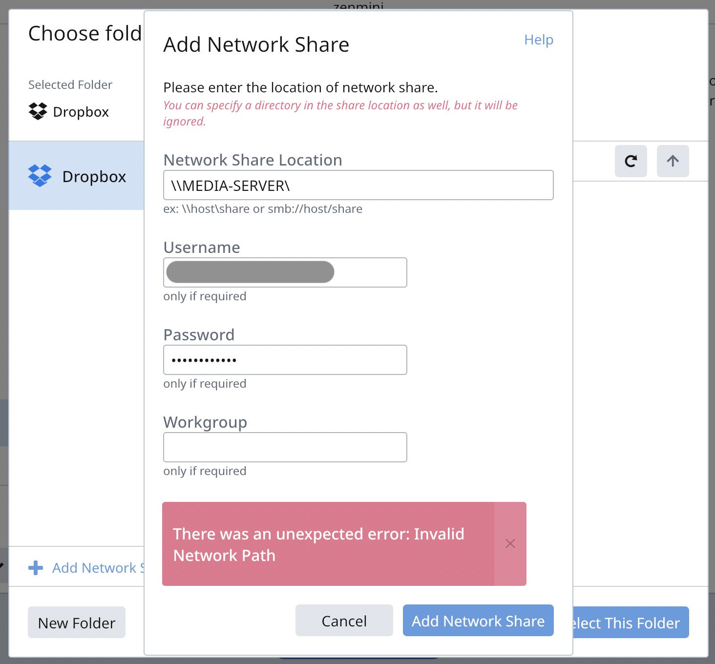

In terms of the path I am trying to use, I have been trying variations on:
\\MEDIA-SERVER\Users\ …
It just keeps saying “Unexpected Error”, not a helpful message.

So the first step here is that we need to make sure the folder you’re trying to access is properly shared on the Media-Server PC. Can you share a screenshot of the share settings for that folder? We have information about that here in our Help Center:
This is what it looks like from my MacBook… Looks fine to me.

Can you try this, I,ve just done a test on my Windows 10 machine to add a share in Roon
On the folder where the back up is right click on it and select ‘properties’
Select the’Share’ tab, press the ‘share’ button
Select your user name, on the bottom right press the’Share’ button.
this should share the folder.
You should see something that says ’ To change this setting use the network sharing centre.
If you click that link you should see - Turn on network discovery , and Turn on automatic setup of network connected devices are both selected.
If you don’t know the IP of the machine from the search bar search for ‘command prompt’
then type - ipconfig and press return
In the returned text look for - IPv4 Address , which on a standard router will be 192.168.1.XXX
So this is my entry in Roon to add the share , the user name and password are what you use to log into your PC.
