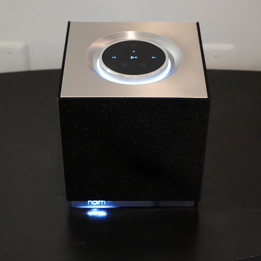

Unfortunately, the ONLY streaming protocols that the Mu-So 1 supports are AirPlay 1 and Bluetooth. The former currently requires the Apple Home app with Roon, the latter doesn’t help you because Roon can’t send via Bluetooth. For confirmation, here is the best list of Mu-so 1 specifications that I can still find. (It’s for a Mu-so Qb Gen.1 but this is the same as the larger Mu-so Gen. 1):
Therefore, there is no other streaming protocol that Roon could use (like Google Cast, for instance), because the Mu-so 1 doesn’t support any.
In addition, the Mu-so has no hardware inputs, meaning that there is no way to plug it into a the Roon Server computer or into a separate streamer, either.
