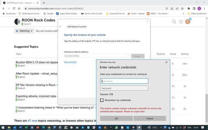

I tried the suggestion, but neither of them works. See the screen shot of the right hand screen.
try a username of guest with no password?
Are you logged into a corporate network? It’s looking for a domain controller
Is that a typo, you did mean \\Rock\ as shown below…

Sorry, here is a better screen shot of where I got stuck.

In Windows File Explorer, try typing \\rock\ into the Address field directly… If it doesn’t work, please show a screenshot of the error message you get…
I suspect that because you are using Windows 10 Enterprise, you need to enable insecure guest logins for SMB2 and SMS3 - Microsoft has recently disabled “guest” access for SMB…

SMB1 is not necessary because Rock supports SMB2, but you’re right that “insecure guest logins” may have to be enabled. We have been through this in lengthy threads :wink:

To all, my PM was about insecure guest logins along with a link to a fix
Indeed - and I can’t find one at the moment; can you help? :slightly_smiling_face:
Thanks. I have to confess I am out of my depth here. I will have to get somebody who knows how to enable the SMB2 settings that you refer to.
