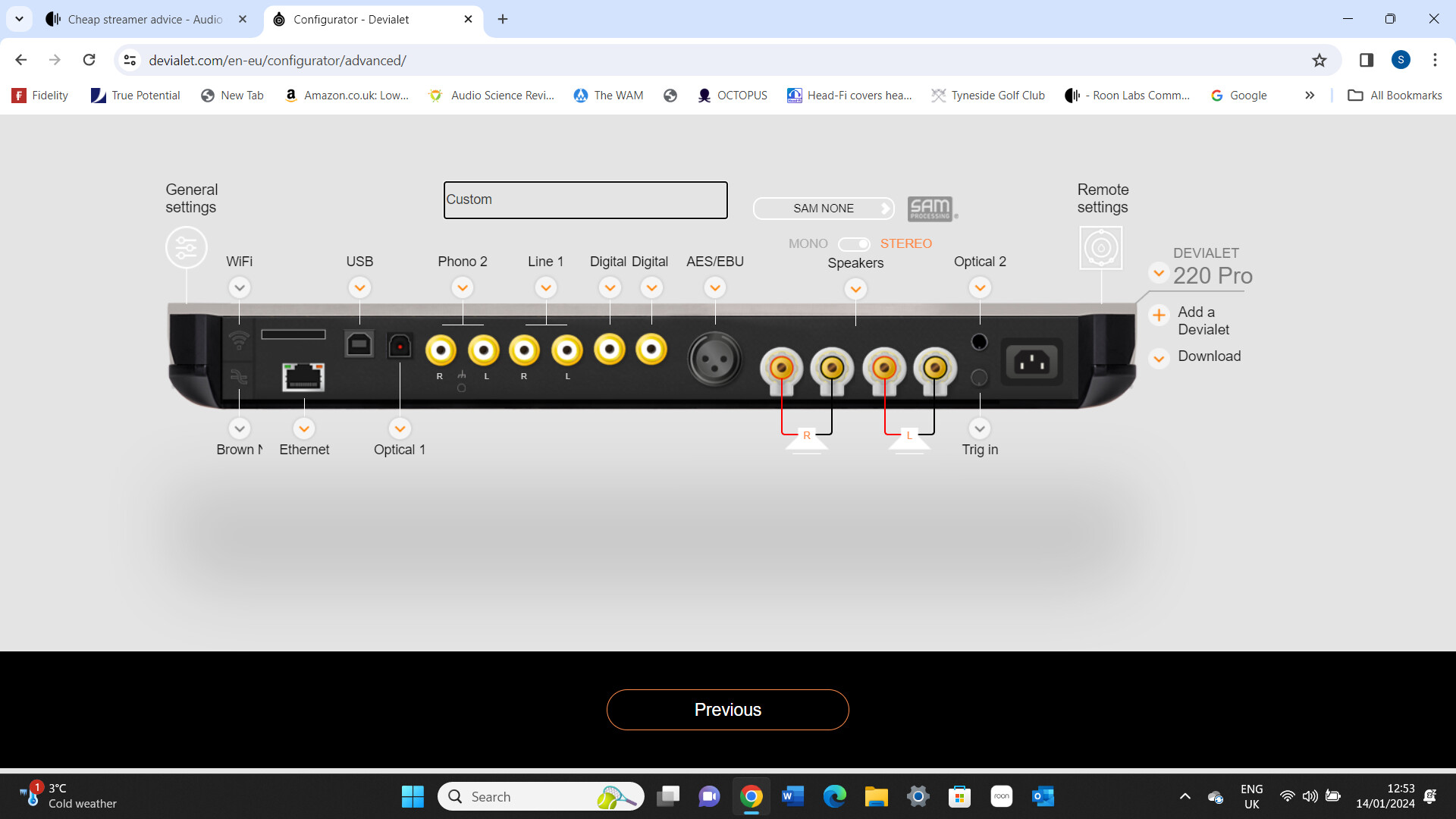

So I may have hit an issue. I was just about to order the Wiim Pro and did a little further reading.
It looks like I have to connect the Wiim to my Devialet, looks like by Toislink.
The issue I configured my digital inputs years ago to use with Headphones.
I no longer have an SD card reader in my lap top so cant change my SD card which gas the configurator saved on it.
I could buy a cheap SD Card reader I guess, but chaging the configurater for me is just more time away from music.
For some reason i thought an Ethenet connection to the same switch as my Devialet would be the connection.
Am I getting a bit lost here :grinning:
I beleive it did have until I changed the Configurater.
Like I said above I can buy an SD card reader and change my settings, however I am only buying an addditinal streamer because the current Roon issues are dragging on…so considering waiting a little longer now
It looks like I have two digital inputs ?
Sorry I have no idea.
I do know the two pre outs shown above can be reconfigured as they were initially digital inputs.
This was the origianal set up
You can set Digital 3 to being Coax SPFDF via the configurator.
If getting the coax setup is an issue, the latest Node can use it’s USB as an output, I use that into a DAC. The iFi Zen does as well, however it’s more of a headache to setup than the the Node.
Yeah they seem great value
As I won’t be needing the better DAC as the Devialet has the DAC I think the Pro would be suitable for me
SD card reader bought from Amazon this morning. For £10 I cant go wrong :grinning:
The only thing stopping me buy the Wiim is sods law Roon will sort the IOs issues out and the Wiim would never get used ever again. Oh and the hassle of having to take the SD card out. My D200 is hard to get to and I need to be a bit of a contortionist to get at it :smile:
