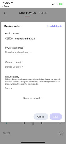

Below, the screenshot of device audio setting on Roon.
As you can see, there is no option regarding DSD.
No DSP setting is used.
Firmware of the device is 1780, the latest.
Thank you
I’d contact cocktail.sudio and ask what they got certified by roon.
Those settings explain why it’s converting as that’s what it’s telling Roon it supports just up to 192/24 pcm. So either some setting on the device is stopping it seeing anything else or they never got it certified for higher which seems odd.
