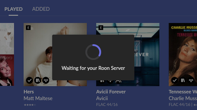

· Roon Server is on, but I'm still having trouble connecting.
· "Waiting for your Roon Server"

When you try to connect, what screen do you see?
· Just the Roon logo
Please try to restart your Roon Server by closing the Roon app in the taskbar or rebooting your Roon Server machine.

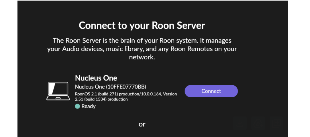

Thanks for reaching out. I am looking over your account diagnostics and I do not see your Nucleus showing up on our end. Are you able to connect to the Nucleus Web UI properly? Can you share a screenshot of what you see on the WebUI if so? If you press “Select a different Roon Server” button from your screenshot, does the Nucleus show there?

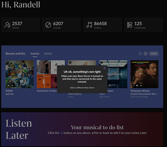

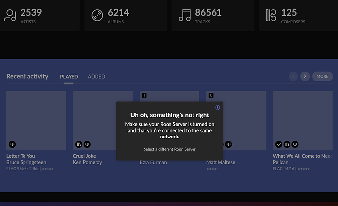

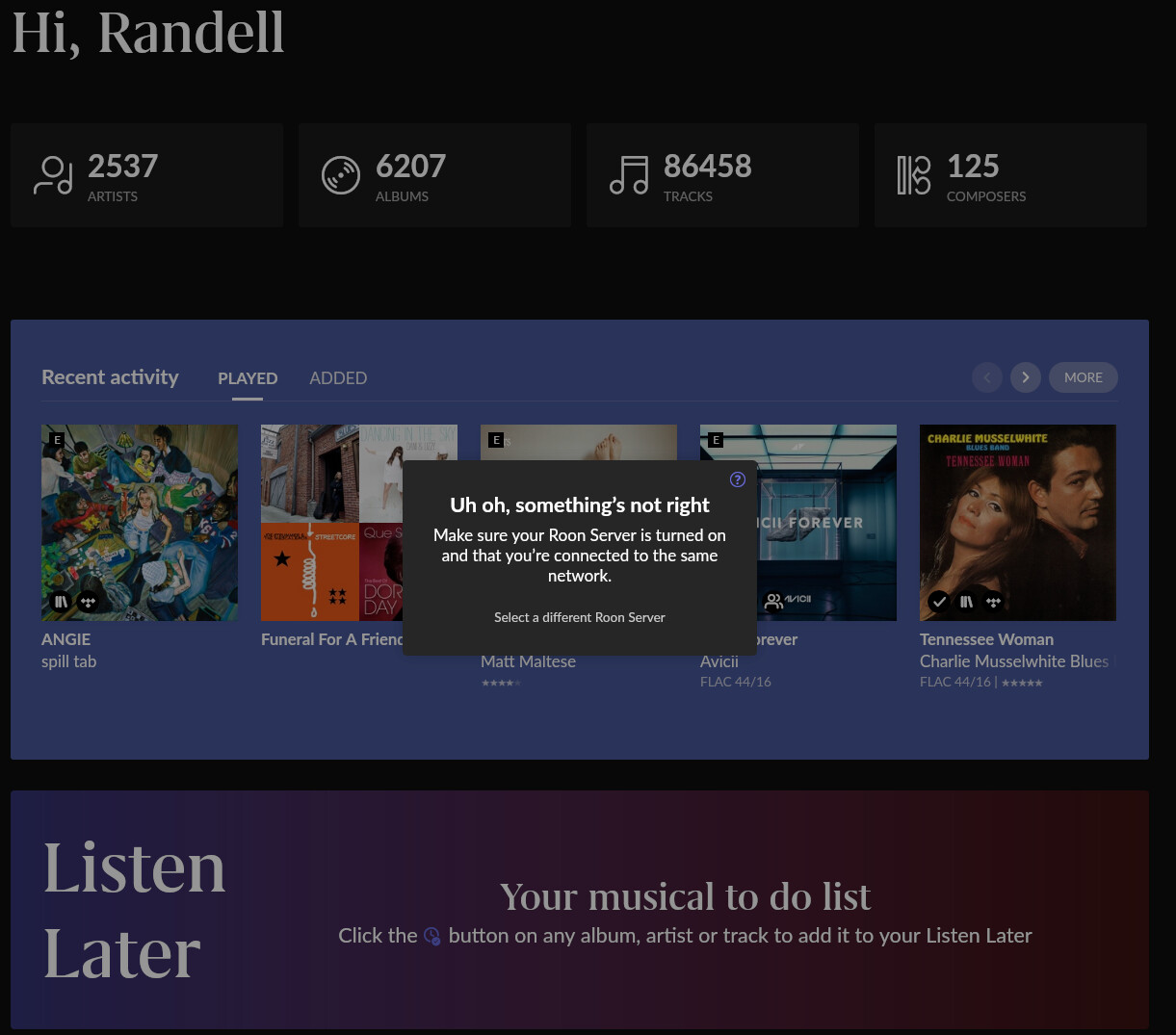

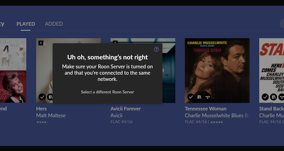

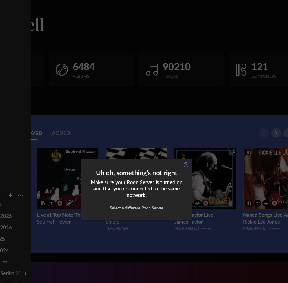

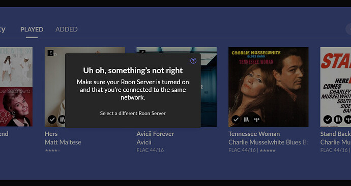

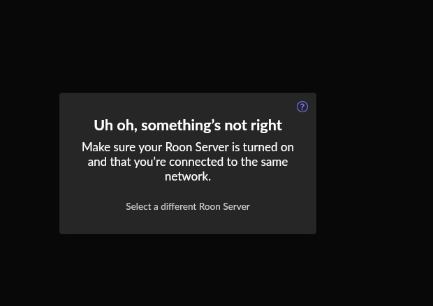

It takes a long time to connect and sometimes works and then I see this
You can see in the background that my library is available.

Based on your screenshot, it looks like your library could be hitting the ceiling for available RAM on the Nucleus - if you temporarily disable half of your library, and only run ~40k tracks, do you still have issues?

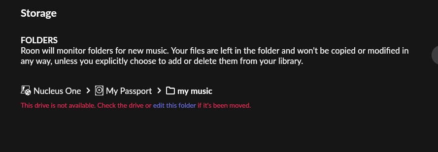

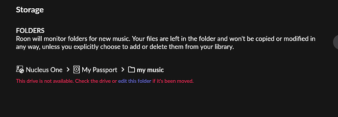

Now the Nucleus is not reading my external drive.

Hi @randell.gee50,
What format is the “My Passport” drive formatted to? I suspect it is NTFS.
NTFS file systems don’t like it when they are hot-unplugged. That’s why Windows has this:
The file system is now probably flagged as unsafely removed and ROCK refuses to mount it:
Please attach it to the Windows machine, start a command window as administrator, run chkdsk /f on the disk. Then remove it safely from Windows.
Note that Roon does not recommend NTFS for external USB disks connected to ROCK/Nucleus:

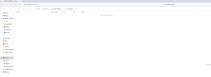

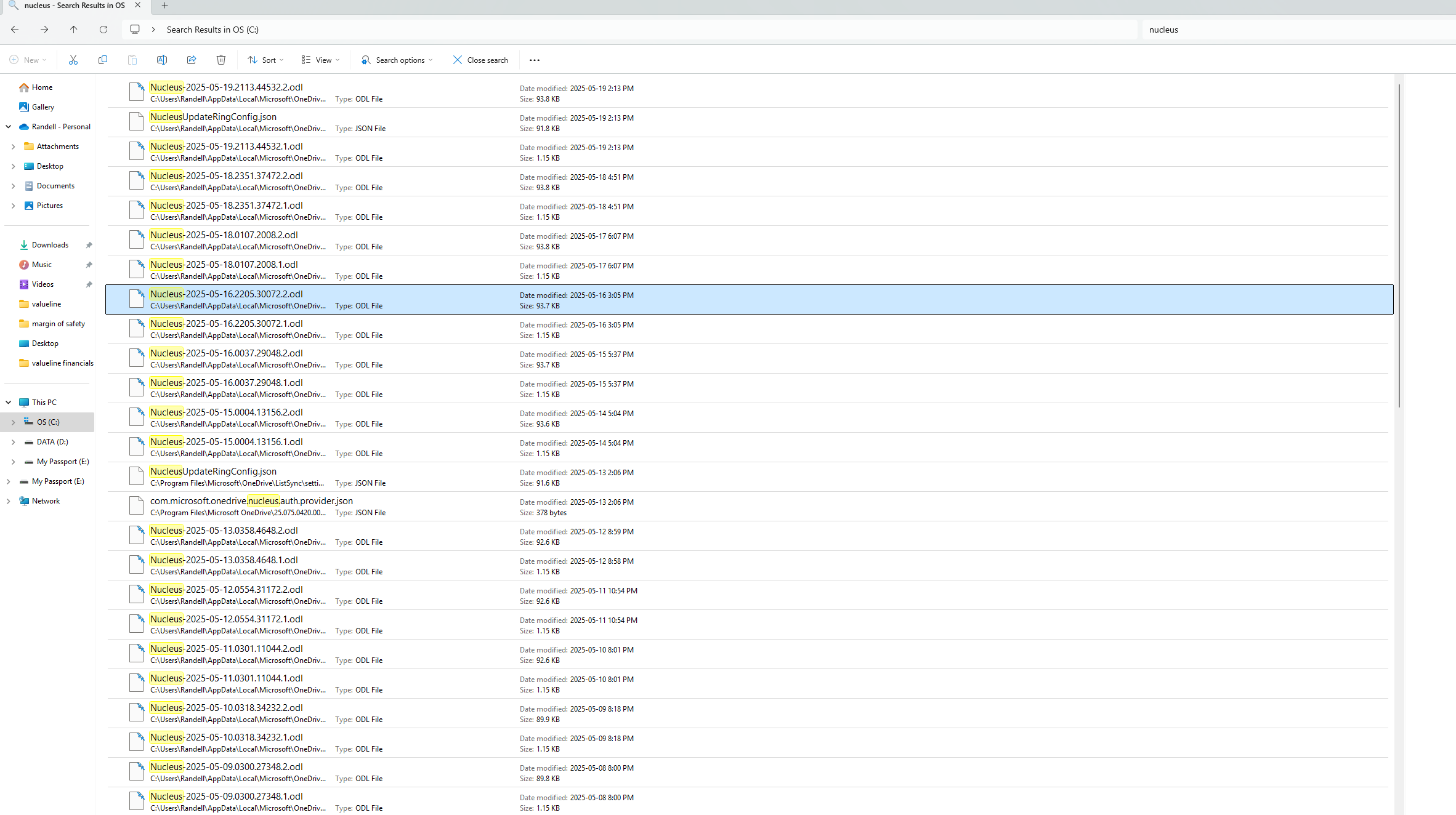

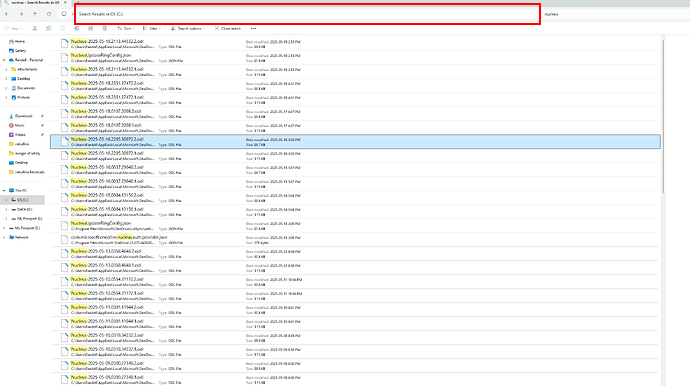

This is what comes up after searching for nucleus.
I can’t read the entire file location but it’s in OneDrive.
What’s my next step?

Hi @randell.gee50,
Sure that would work as well!
I’m sorry for the confusion but just searching won’t show you the files you need. You need to type \\NUCLEUSONE\Data into the address bar in File Explorer. You can see the address bar with the red box around it in the picture below.

I’ve tried that but I don’t get a match.

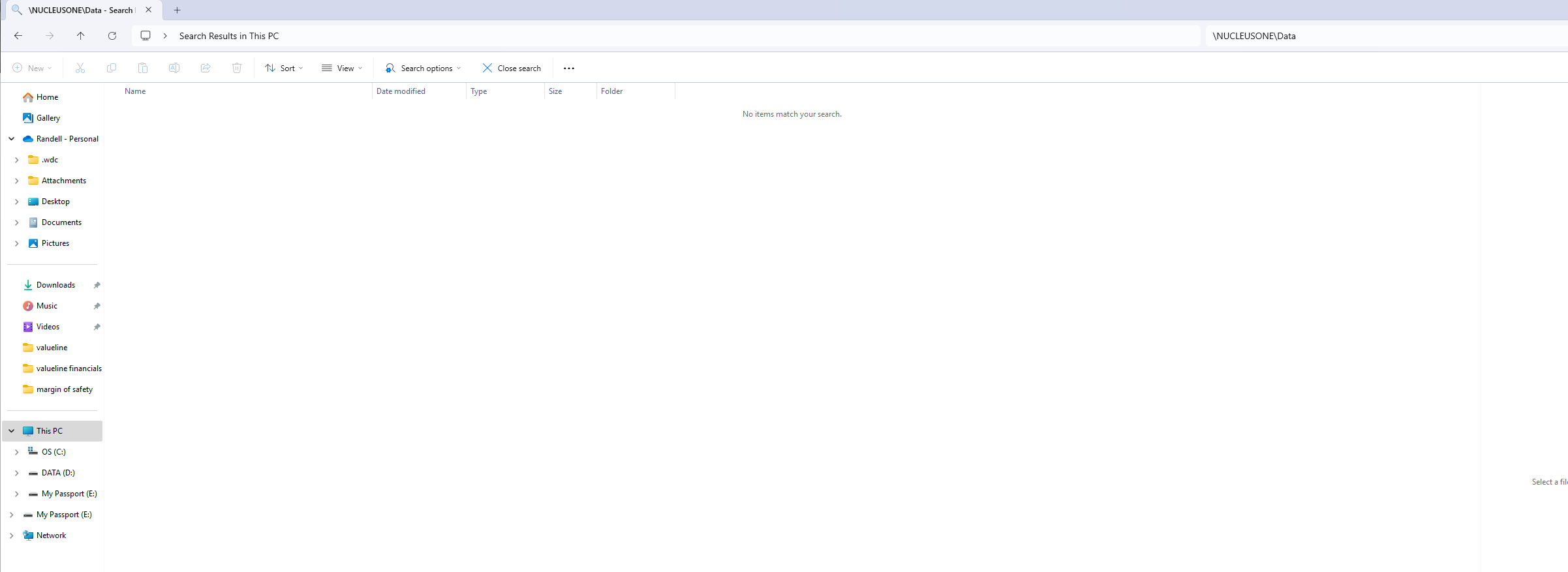

It took a few days but I transferred all my music files to exFAT and I still have the same issue.
I also tried the search for \NUCLEUSONE\data and no matches were found.
Should I just wait for the entire database to load?
