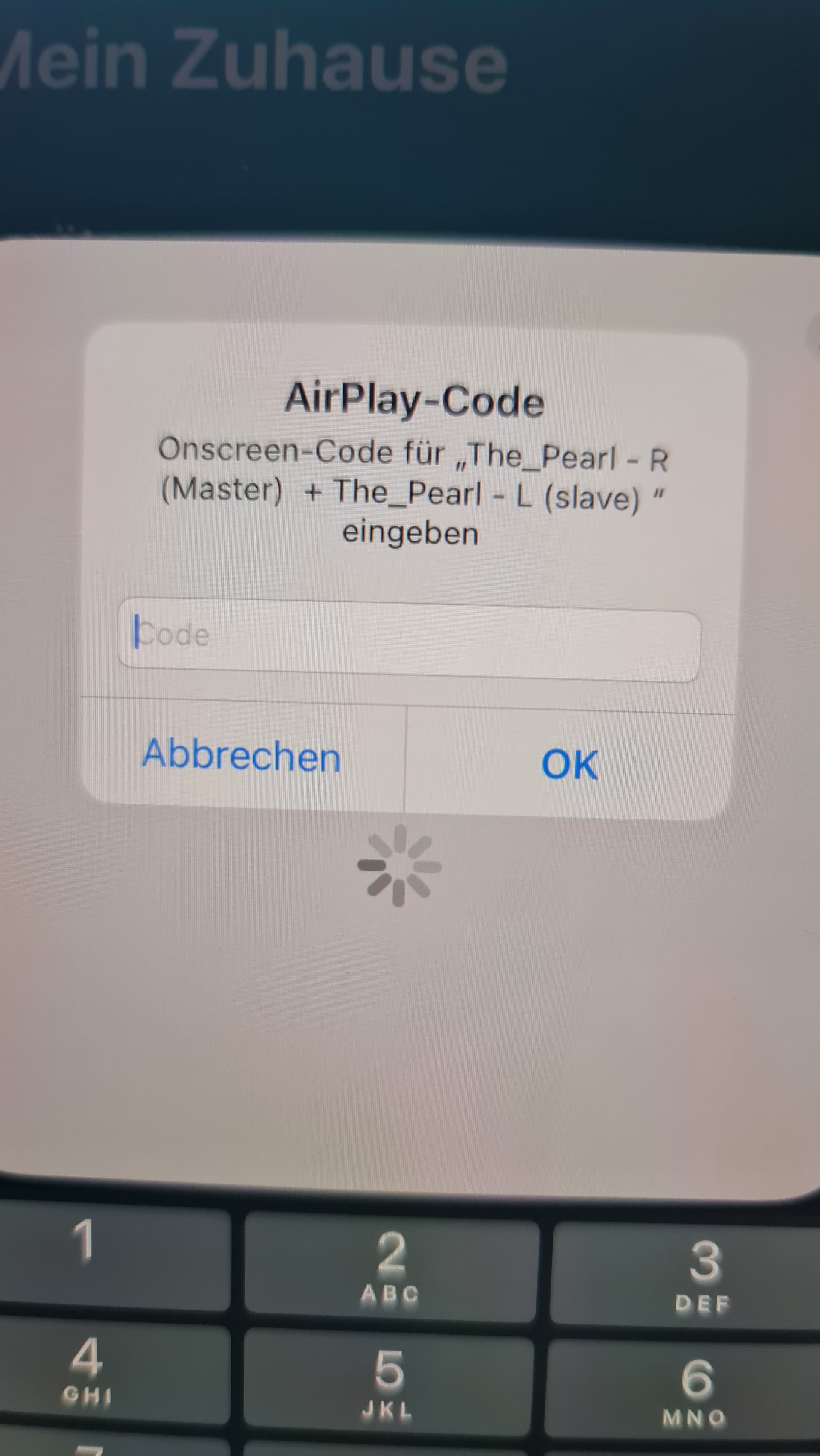

After having a chat with the Cabasse support, they told me, that to enable the Airplay-functionality, I need to use an iPhone and the home app, as referred in your knowledge base article. Most important information to do this was, that this is a one-time-action only, so after having done this exercise, it should work with Roon… so far so good, in theory. The only problem: After step 5 in your knowledge base article, unfortunately there is an additional step “to enter your PIN” – and I couldn’t find a way to disable this request page in the home app, and I don’t have a PIN either. So the process stops and that’s it…
And after asking the cabasse support again, why they are requesting a PIN, they told me, that the request to use the home-app in iOS and to enter a PIN is coming from Roon-software, not from the device…
So I come back to you once again - what I need to do, that it will work?
Any idea what to do to overcome this problem?
And seriously: Why isn’t it possible to have some kind of default configuration in Roon, that even a PIN isn’t needed, or just a default PIN is set, so that the installation process has a chance to work without using an iPhone (as with me, as I’m using Android only), or that by using an iPhone, the PIN to type in would be written somewhere… Or do you have maybe a QR-code to work with the home-app?
Please check, maybe with your development team, how to overcome this issue - and to get the pearls working with Roon as well…

First: Thanks for your comments. Let me answer… @Martin: In which application? Within the home-app of iOS, after selecting the pearl the PIN-request pops up. In Roon, I can select the Pearl (it’s an active player), pressing the play button, green dot appears - and that’s it. No Playback, no progress in the progress bar (only this animated sign in the player list shows, that music is playing - but it’s not…).
As said, According to Cabasse, the pearls are not requiring a PIN for Airplay - and you are stating, that Roon doesn’t require it as well - but in the home-app of iOS, it’s requested, and that is in contradiction of your article in the knowledge base…

In the home-app I searched for any options to maybe disable this PIN-request, or doing somethin different with it - no success, unfortunately. I couldn’t find anything towards that functionality… And it seems to me, that only numbers are allowed, no characters - at least, I’m only able to type in numbers…

Hi all,
Now attached the screenshots of the iPhone. I tried different ones, and all the same… The pearl is listed in the device-view, but as next screen the PIN request is coming up…
Hope it helps…
Walter
Thanks for the screenshots (of the Apple Home App).
I also had a read of the Roon’s Knowledgebase article … as you say there is no mention of PIN numbers, so I’m wonder if something has changed with Apple’s Home App since that was written.
I’m struggling to see how this is related to Roon application as at this stage the communication (to set up Airplay) is between the Apple Home App and the Cabasse Pearls … so I don’t really understand this comment from Cabasse support …

But maybe the SW-version is the root cause for it? Maybe there is an incompatibility between AirPlay1-servers and AirPlay2 devices? Cabasse told me, that they are happy to have it programmed with full AirPlay2-support… maybe that’s the reason?
