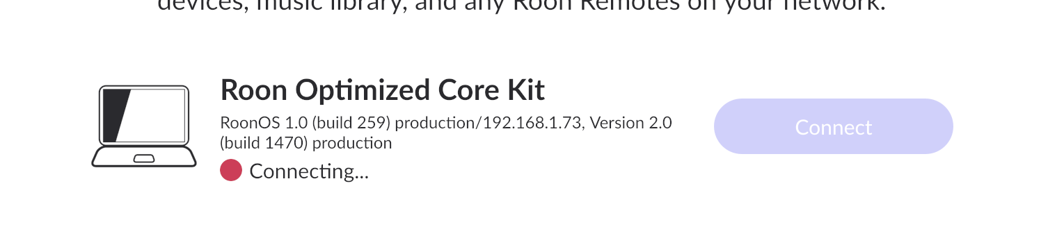

Roon Core Kit is installed on a NUC i7 (32mb mem, 256Gb SSD and 8Tb storage. Roon remote installed on iMac (27-inch, i7, 2020), MacBook Air M1, a couple of iOS devices, FiiO M11 and two Windows 11 laptops. The latest versions of programs (build 1470) are installed. NUC and iMac are wired (1 Gb), NUC has a permanent IP Address, no VPN/anti-viruses. The problem occurred after upgrading macOS to version 15. Once the connection to Roon Core Kit is broken for any reason, it is impossible to reconnect. Remote sees the server, but the connection status is always “connecting”. iOS, Android and Windows devices work quite well. Uninstalling and reinstalling Roon remote has helped a couple of times, but now this method stopped working.

macOS 15 messed up security settings for quite many people. Lots of threads about this on the forum. Try this, it usually helps:
Navigate to macOS System Settings > Privacy & Security > Local Network , and make sure Roon is allowed. If it is already enabled, toggle it off and on again. Then reboot your Mac, and see if the same issue persists.
Thanks for your reply.
I’ve done this many times. Unfortunately it does not help.
Will try to reinstall again both remote and server, reconnect all wires. It used to work…

I don’t know what exactly helped, but after soft reinstalling and wire reconnecting remote could establish a connection.
Now it will work until another connection failure (on my network this happens from time to time when a large amount of information is copied e.g. backup to NAS).
Logs are uploaded.
