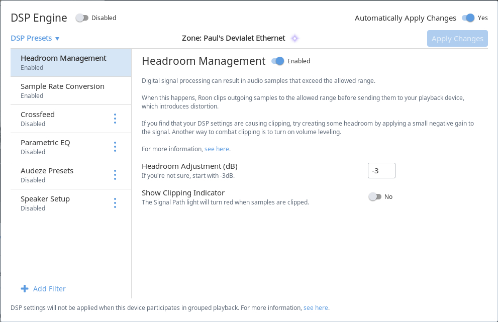

Can you please confirm that the crackles are still present with “Headroom Management” turned on in the DSP settings for that zone? I would try with a -3dB setting to start off with:

Currently, I have DSP settings disabled and I play a native 24/192 file from the external SSD (see DSP settings in attachment).

@Paul_Jeno on your first screen shot: enable the “DSP Engine” (in the top left corner) for the Headroom Management to take effect.
Did that and it didn’t help at all.
