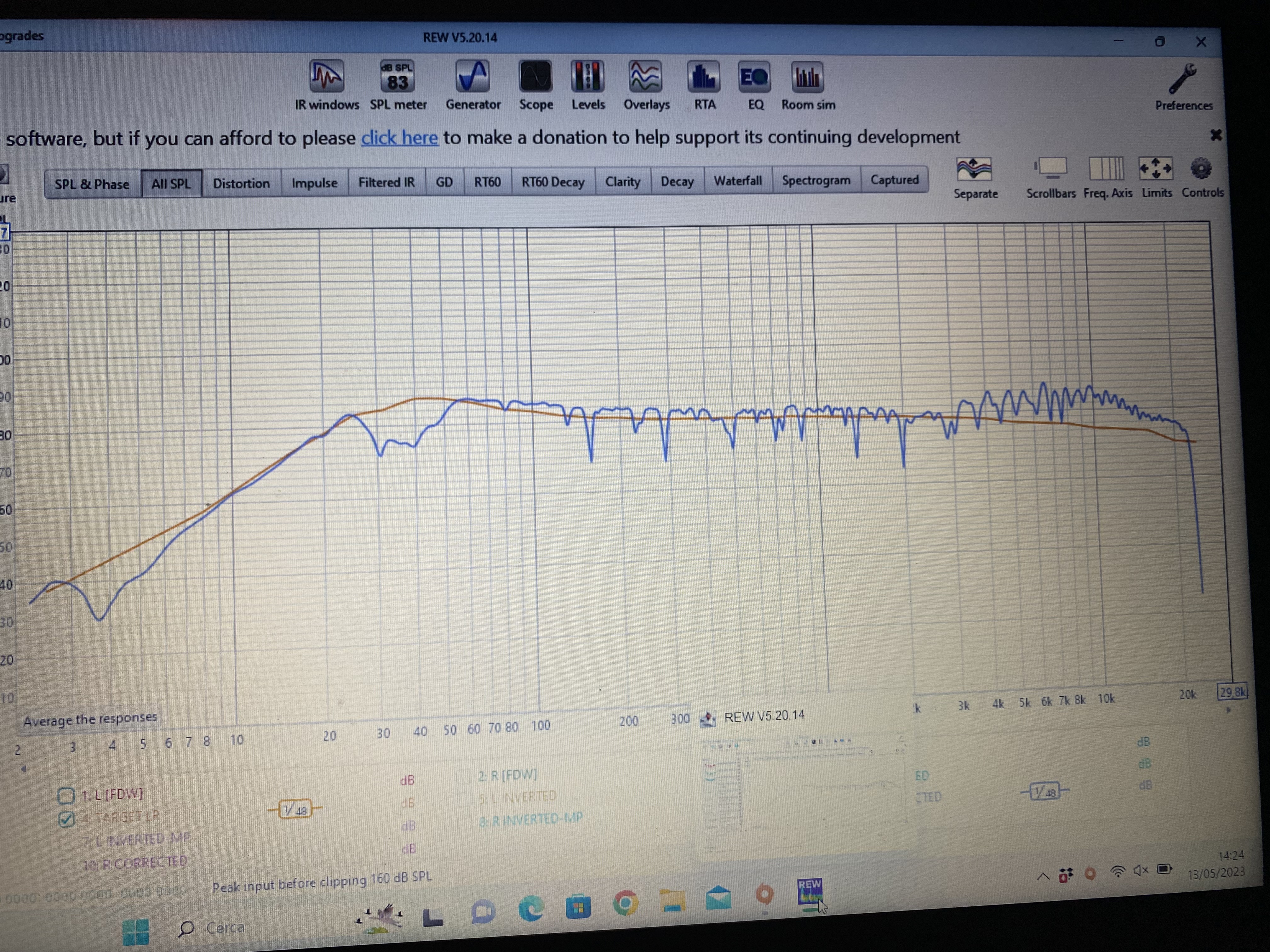

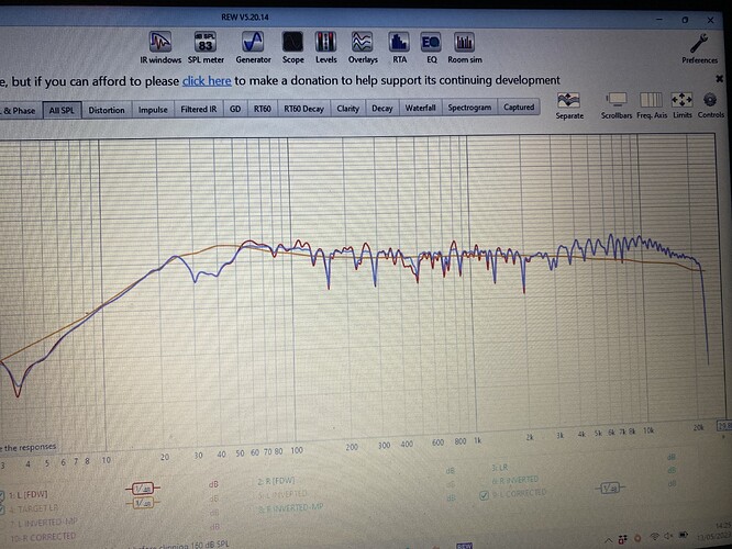

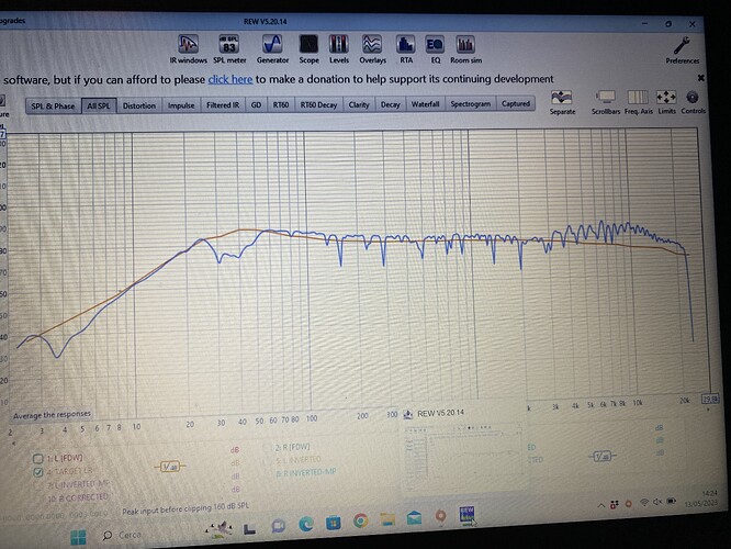

In the inversion procedure now it is necessary to set the target on AUTO and not on 3.6 dB. The problem is that L CORRECTED is not aligned to the target but about 3 db above it! What am I doing wrong?
My correction is 55hz-1900hz.

Whereās R CORRECTED showing up? As long as they are at the same level thereās no problem. If thereās a difference, you can adjust SPL offset values of 1/A-MP according to the target level shown in the notes section of 1/A operations. Please note that the convolution impulse files generated do not have volume information in them.
R CORRECTED is at the same level of L CORRECTED.
So, no problem?
But it is strange that the correction isnāt in level with targetā¦.

Yes, no problem at all. REW uses a 3dB offset during some trace aritmethic operations to avoid division by 0 errros during fast fourier transformations. Testing the filters by ear is usually the easiest way to move forward.

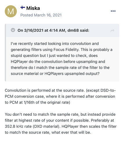

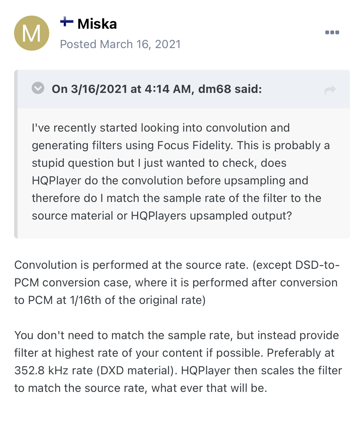

Just to note that I unchecked Apply IR Window before Export as Mark Reed did and my bass was saved and itās brilliant. Iām not so sure Iāve done the best job but improved by at least 10%, probably more!
So, based on this info from Miska himself, if we plan on using this convolution filter in HQplayerā¦.should we not be exporting the convolution file in 192k sample rate if for example, we are streaming Qobuz or similar?

I have not used HQPlayer myself but people here have successfully implemented these filters with it. You will need to export separate mono convolution files for the left and the right speaker at 48kHz.

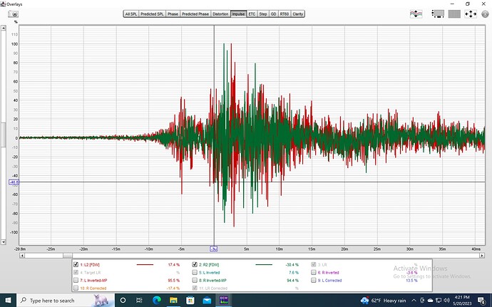

I followed your directions exactly, but had a couple of issues along the way, mostly that my Overlay/Impulse screen doesnāt look anything like yours - i originally tried taking measurements using REW on MacOS, but switched over to Windows (using ASIO drivers @ 48K) to see if that would change anything and it did not. I do not see an acoustic Ref Peak (and my waveform looks much different), no matter how many times i try to take measurements. Iām using a UMIK-1 mic to take measurements, and iāve tried using both the output of my laptop, and an external USB audio interface with no difference. i skipped the Impulse part of your instructions and moved on to the rest and created Corrected curves etc, but iām not sure if that makes the rest of the workflow wonky or not. Once i loaded the convolution files into Roon i found that the system sounded a bit dull and lifeless compared to the non-convoluted output.

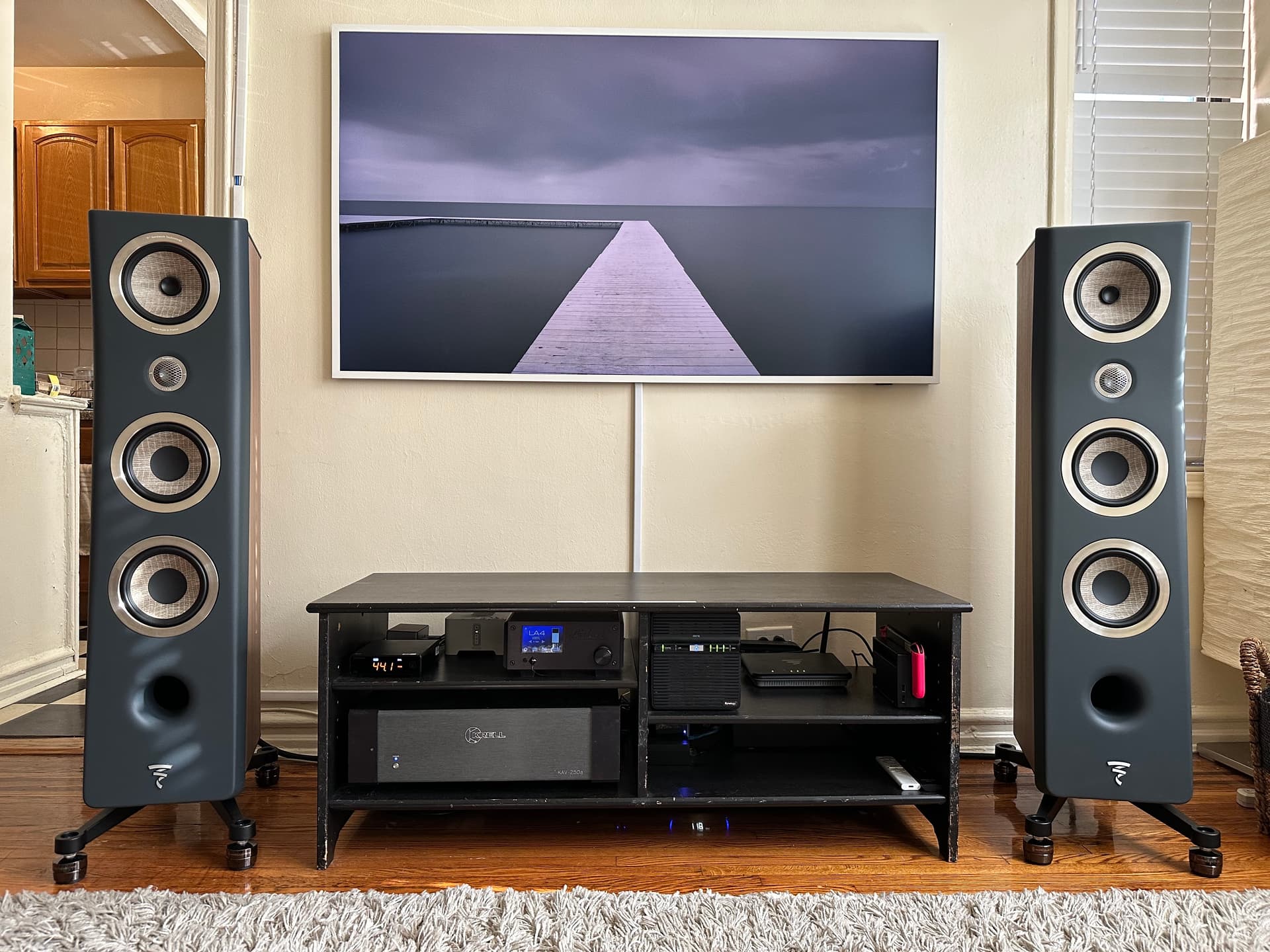

Incidentally, Iām using the exact same speakers you have pictured in your pdf - the Focal Kanta 2ās.

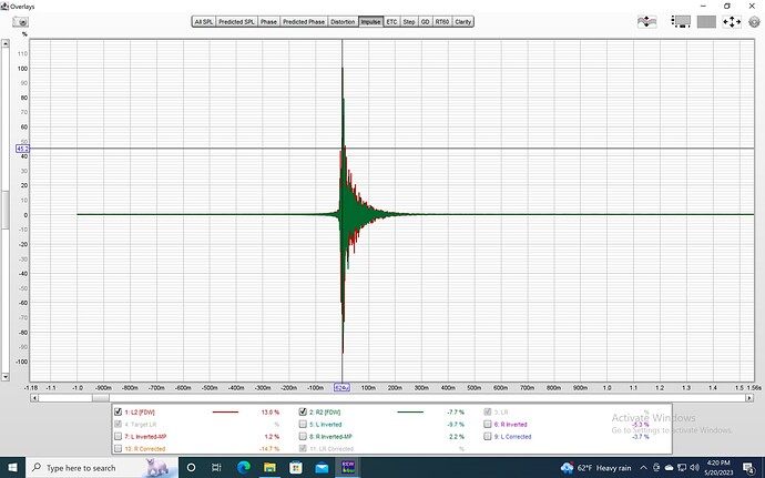

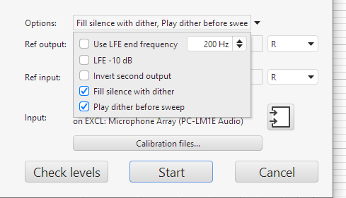

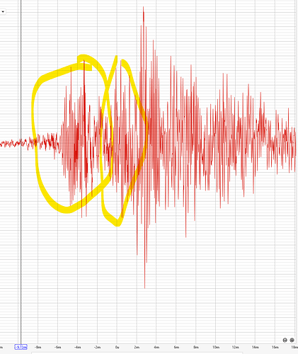

Not seeing acoustic reference chirp is normal. It only means your system doesnāt have any crosstalk between channnels which is in fact how a clean system should be. However, when I look at your measurements, I see over 8 ms system delays which corresponds to 2.5 meters. Thatās absurd, something is set up incorrectly in the measurement chain. There may be a bunch of reasons, some DACs take time to activate after the first signal arrives. I suggest you download the latest early access version of REW from the link below:
Use Java EXCL drivers to eliminate potential ASIO buffer size related problems, make sure USB Audio and Umik is configured correctly in Windows Sound settings (48kHz sampling rate, all enhancements disabled, exclusive control to other applications, etc.) and in REW tick āPlay dither before sweepā under options in the measurement window.

i plugged my laptop directly into the DAC via USB and it dropped my system delay measurements to ~ 1ms so it seems to be much better. (i was previously using analog outs of laptop, and a separate DAC, which seemed to be the cause of that delay).
attaching updated measurements here - there are 2 per channel:

I am not very happy with these filters though because thereāre still fundamental problems with your measurements. Right speaker is always delaying more than the left. L and L2 have reversed polarities which shows an inconsistency between measurements. I had to pick the best ones out of each measurement because vector averaging simply nulls them. Is there like a speaker distance setting in the Dac or the amp? Or are all speaker cables correctly plugged in.The setup still needs investigation IMO.
Note: Try taking 1M length measurements, 4M might be too long for a USB mic. This is not the cause of the problem but always take 0-24000hz measurements, these were 20-24000.

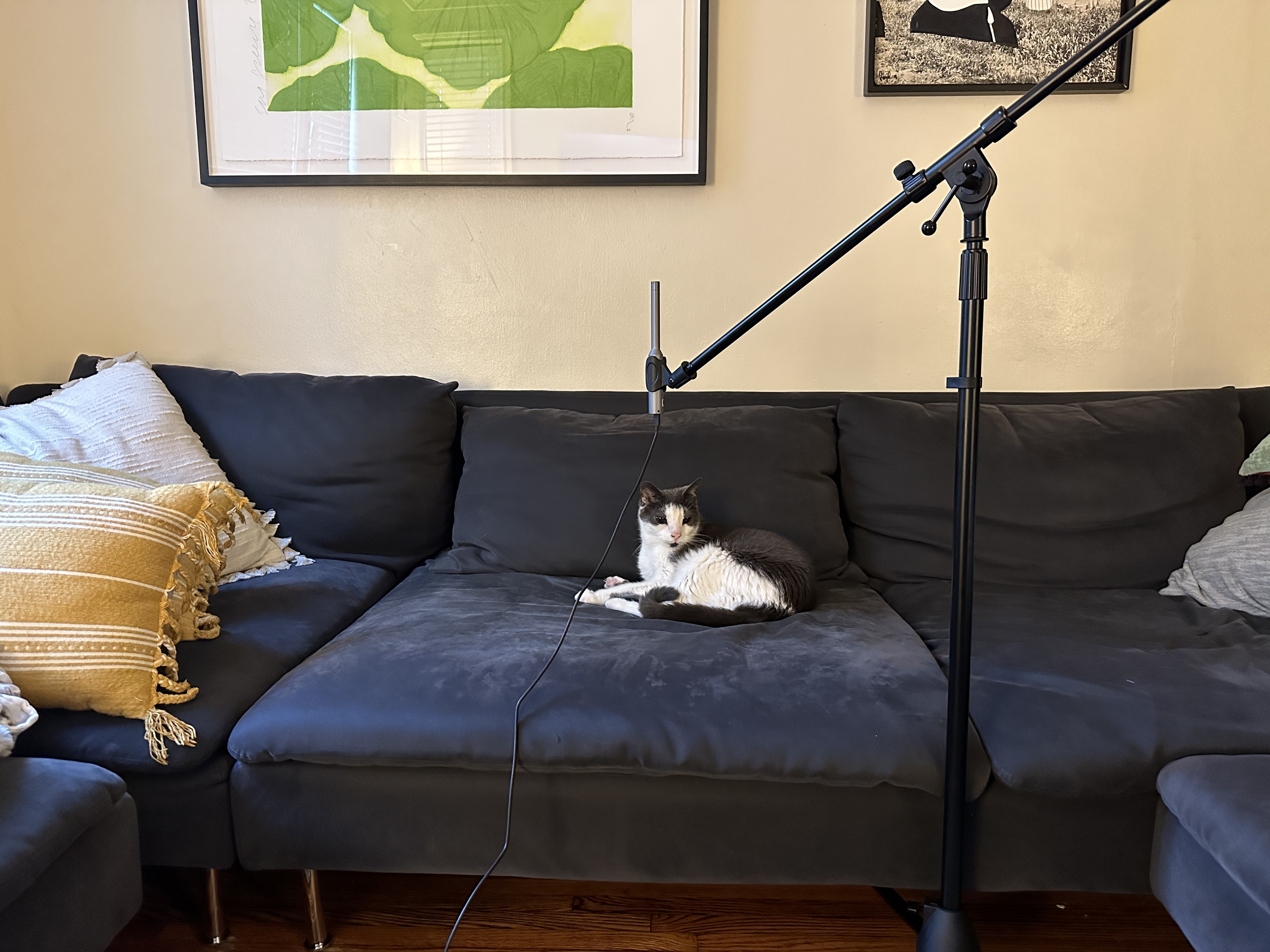

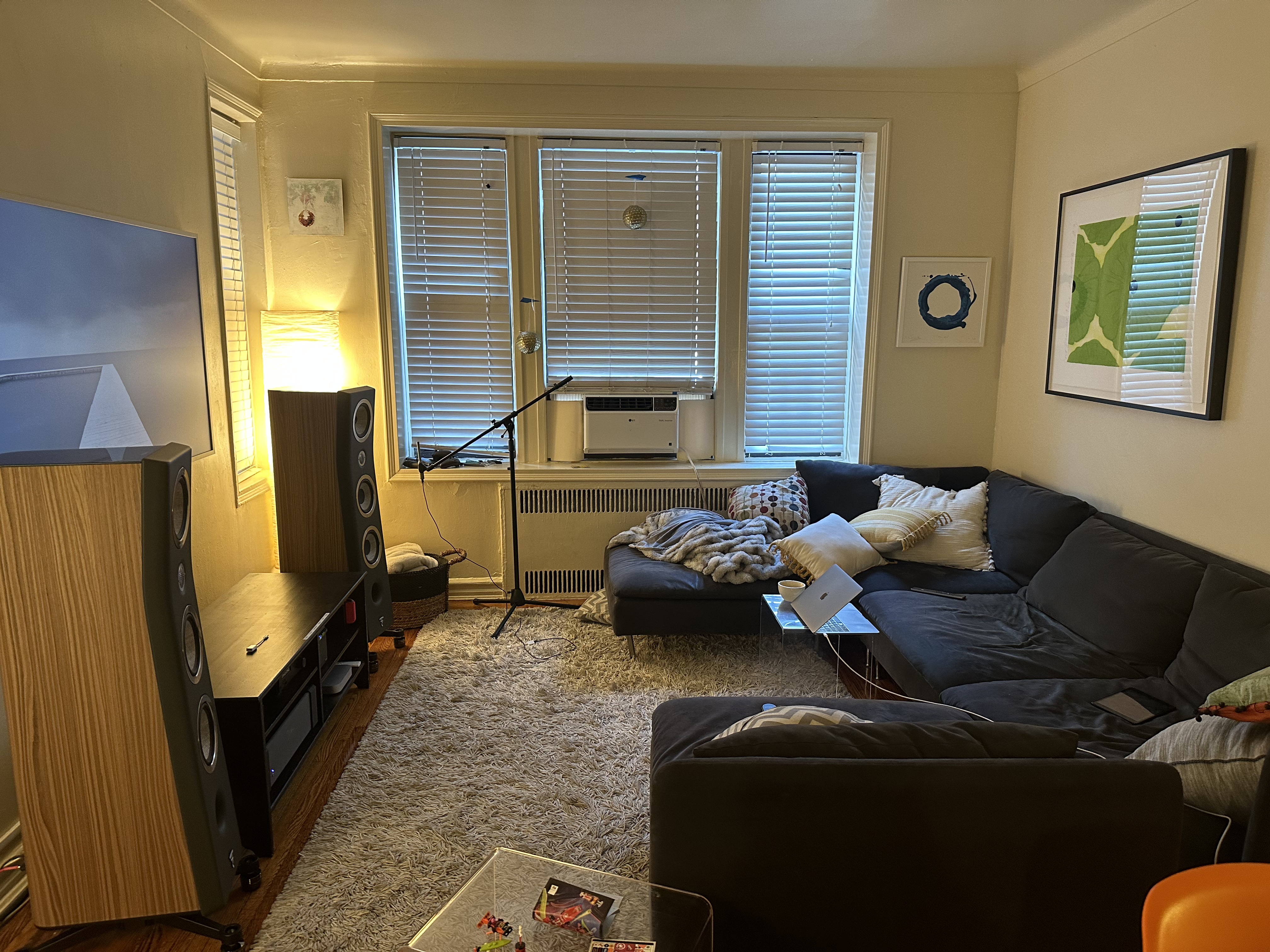

iām wondering if the measurement anomalies are related to the actual room layout - my LP is on a couch directly in front of the wall opposite the speakers which does create a bit of a bass trap. pics attached.

It could be the cat

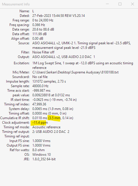

No, the different delays between channels are independent of the speaker or mic location. Whatever it is, itās in the hardware. Your room setup seems fine in general except for the open space to the rear of the left speaker which is causing less bass from that one but it can be fixed with DRC.
And I have checked all your measurement settings, nothing seems to be wrong at that front either!
When you can, try taking repeated (like 3 or 5 each) 256k long measurements for each speaker, your version of REW can do that automatically in one go.
For reference, this is my measurement info for the left speaker for a 1M length:
Holy moly those are big speakers in a small room ! (Not a criticism)
