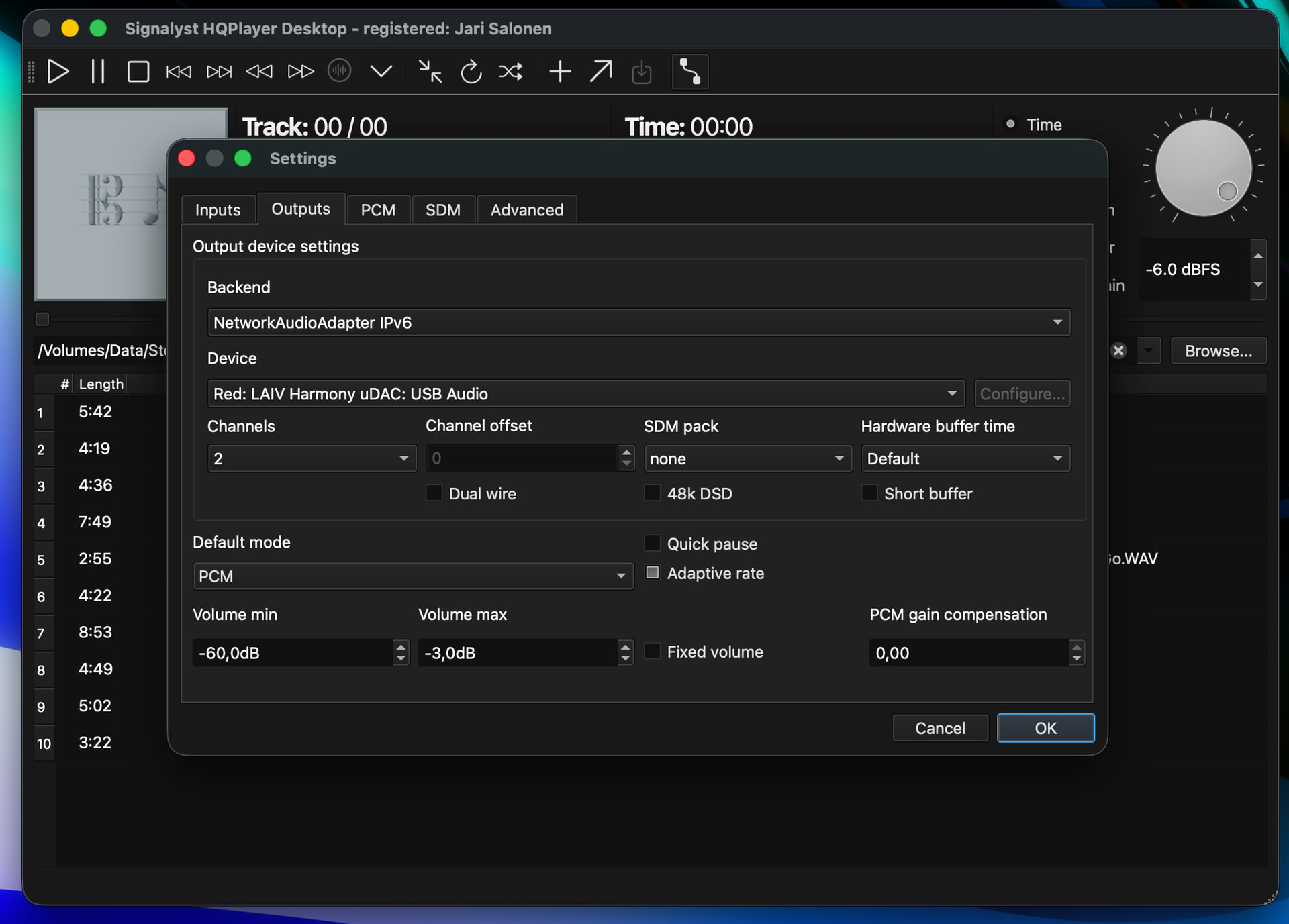

I’m trying to get dac correction for Laiv Hamony uDac funtioning. I have Holo Audio Red as NAA adapter. Using USB-cable between Red and Laiv. Without correction plays fine, but when I enable correction, no sound.
I assume you are on latest HQPlayer version?
You could email me a log file (as attachment please) of playback attempt with that setup, so I can take a look.
I was on version 5.17.0, but after updating to latest version, the problem remains.
I’m trying to figure out how to send log file as an attachment in email…
From Tools-menu “Log export…” and then attach that file to an email.

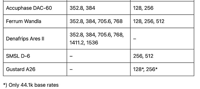

Hi!
Just a heads up for the Accuphase DAC-60, it only supports 44.1k base rates on DSD. Missing "* " on 128,256.
