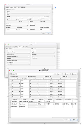

HI, tried the dac correction, with my Mac Studio with USB to Ferrum Wandla and have checked the Matrix and correction enabled, But Wandla does not show up, do I miss anything ?
No correction for Wandla. In my opinion, not ESS-based DACs at all.
Here’s a list of DAC’s which support DAC correction feature of HQPlayer:
https://signalyst.com/dac-correction-support/
And actually Ferrum Wandla is listed there so it should show up. You need to connect it through USB to HQP server or NAA for it to work.
I did try both USB and NAA, both do not show up
My mistake…
I already responded to this elsewhere, but is your Wandla firmware up to date?
my firmware version is the latest one 1.6.1
OK, weird… I assume it is also fairly recent macOS version on Apple silicon? While if the NAA is my latest 5.1.3, then the that shouldn’t matter either…
Somehow your Wandla seems to be different from mine for some unknown reason.

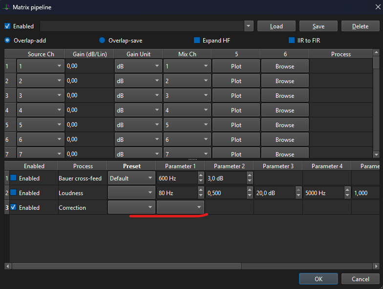

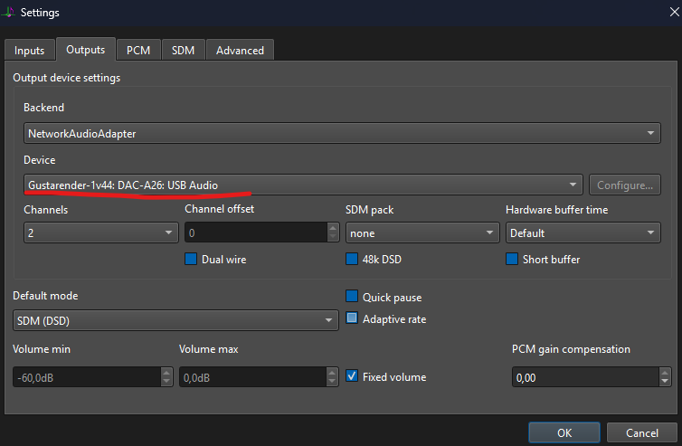

I have Gustard A26 which is in the list of supported DAC Corrections. But I don’t see an option to choose the DAC Correction:
Does anyone know why? HQPlayer Desktop v5.13.0

Which DAC is it?
Hello @jussi_laako
Unfortunately, HQP5 does not recognize my Gustard A26 either. Neither via USB nor via NAA. Is there perhaps a trick here, or can I select it manually?
Thanks and best regards,
Dominik
It probably has something different then in the USB interface compared to what I have. For the DAC correction to work over NAA, you need NAA version >= 5.1. Which OS are you using for running HQPlayer connected to the DAC over USB? Have you checked that it doesn’t complain about lack of internet connection?
